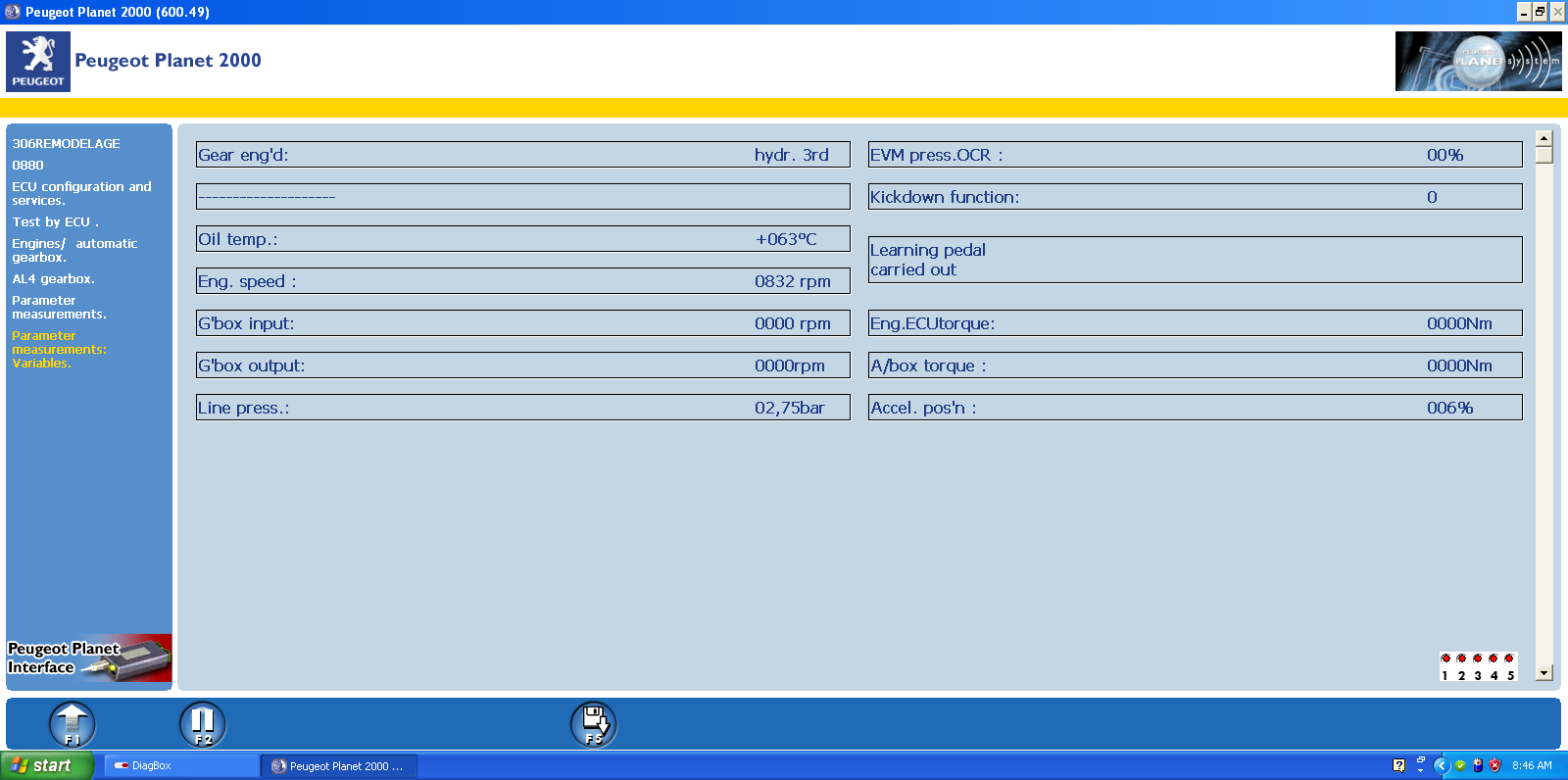

I have attached some images of the some parameters of the car while in D

The first 2 screens show the gear as hydr 3rd, which I think means that the transmission is already in limp mode. Is it like that as soon as you turn the key on, or can you tell when it is triggered?

Yes that's correct... No it only goes into limp mode one it is engaged into drive .....which happens after it fails to engage first gear...
But when I start and use snow mode then it engages limp mode after trying to change to 4th gear.
Basicall the car is constantly going from 2 to 3 to hydr 3 the back to 2 3 then hydr3 as you drive....
In normal drive mode it first gear will not engage at all ... No load will even be felt as you move the gear non to drive unless snow button is pressed.
