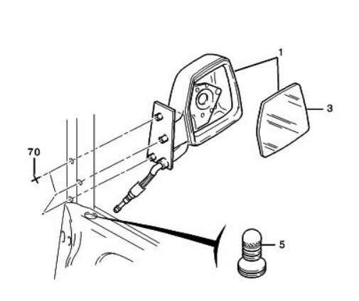

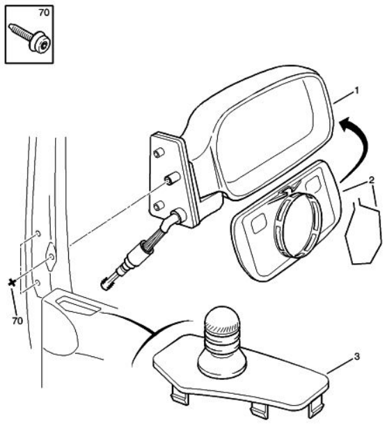

Hi Tony - well yes and no and maybe....
They may have similar fixings - you won't be sure until you come to fit it, but asthetically, no, they are NOT the same - more Euro Car Parts BS again.
Looking at the earliest dispatch (MK I / II) that would be as near to your Synergie, you can see that the fixing looks similar, but the thickness of the mounting plate is a lot thicker and there is no way to tell if the fixing holes are spaced the same. As for the shape and mirror glass - they are a million miles apart. So it depends on whether looks are important or just functionality. I don't think anyone will know until it comes to trying to fit it, but one thing is for sure they are different.
These are just for a comparison using a non-heated manual control mirror as an example:
| Dispatch MK I/II | Synergie |
