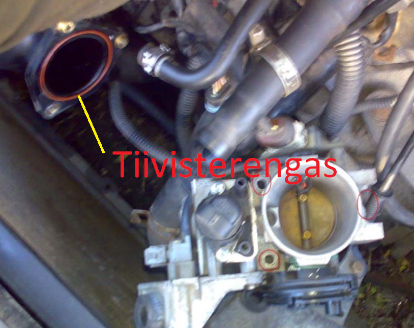

Does anybody have knowledge where to find throttle body seal for Xantia Hatcback (X1_, X2_) 1.8 I 16V petrol? It's a question about the red o-ring between throttle housing and air intake manifold. I have searched a while from the internet but without any success. So if somebody can help me to find the part I would be very grateful and very happy.
The pic is taken from a Xsara but my Xantia has a similar.

Well, now it seems to be so the o-ring (OEM: 036535) is not available for sale and is only available from at manufacturer CITROËN and of course it would cost almost nothing. Oh Lord would you buy me a Porsche 911 for example and the o-ring wouldn't be any problem at all!!!

If you know the dimensions of the O-ring, look at polymax.co.uk or SimplyBearings (also UK) for the item.
You just need I.D. (internal diameter) and thickness. Viton (FKM) quality is oil/fuel resistant.
