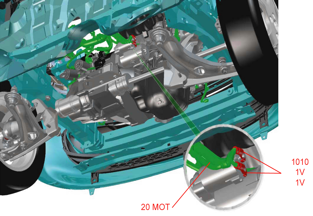

Evening all in order to replace my starter cable on my c1, I was wondering does anyone have a picture of the route the cable takes.

The wiring goes into one of the main harnesses, (20 MOT).
1010 is your Starter Motor and the only wiring I have is here (click image to zoom):

Thanks Marc. Will help loads. Chears
