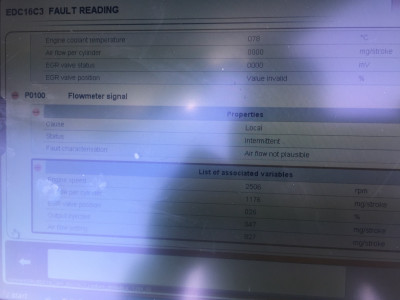

Re: Help Please !
Unread post by Benscab123 »

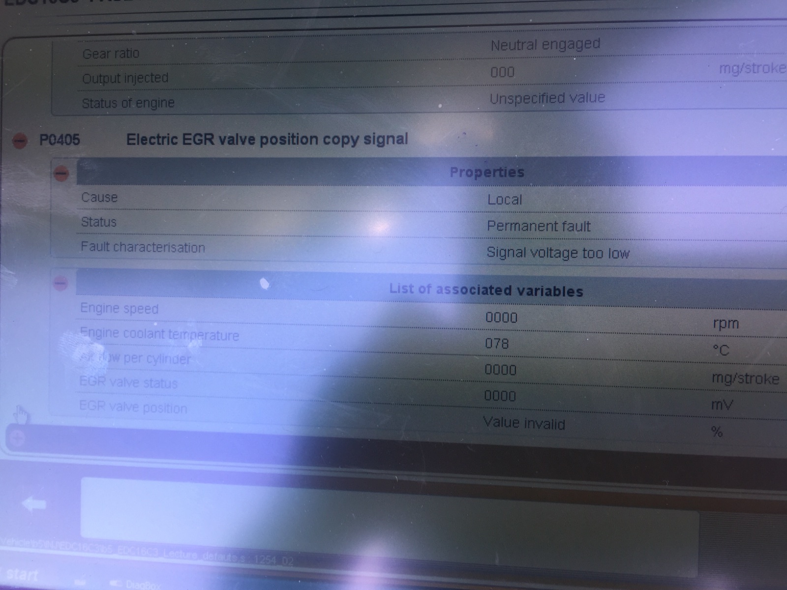

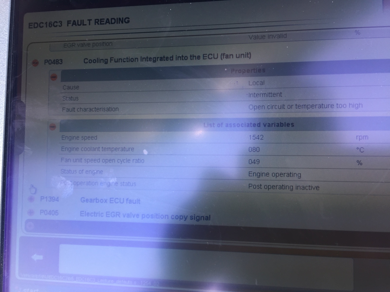

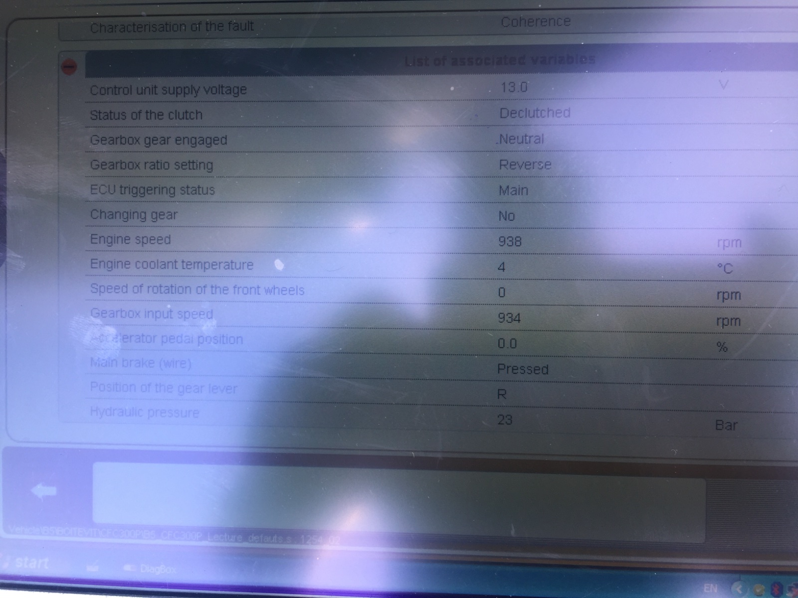

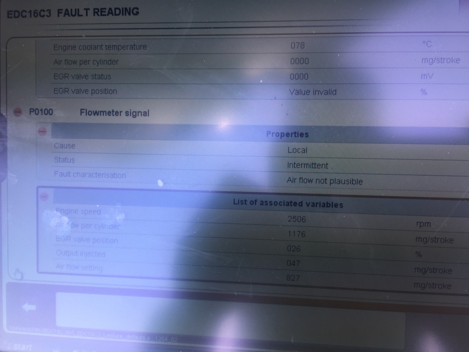

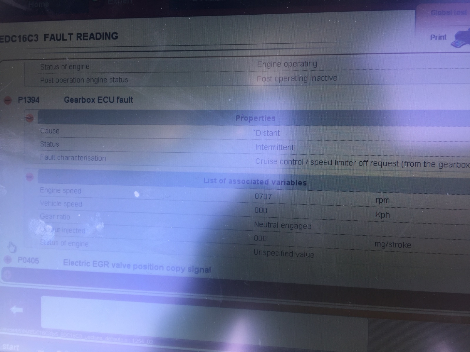

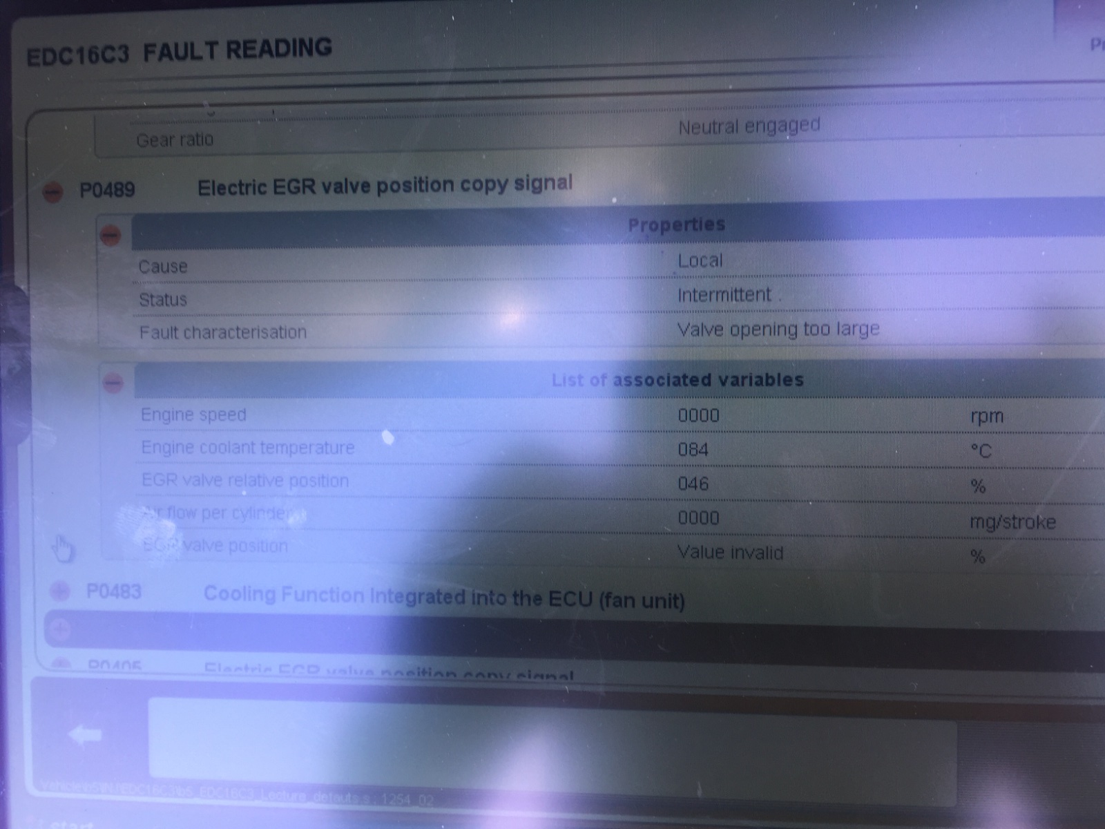

Did a bit of digging on diagbox and came up with these faults, the only one that wouldn’t clear was P0405. Also did an actuator test on the EGR and couldn’t hear anything .
