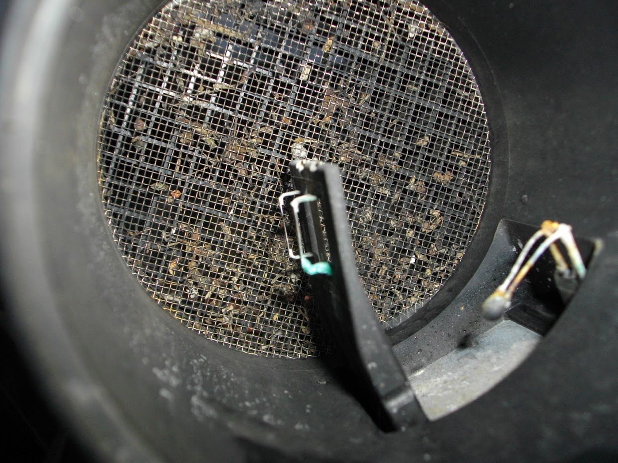

Did you notice a little green 'bead' in the MAF?
That would be the thermistor for intake temperature.
Ruined MAF
Ruined MAF
On the right at 5 O'clock.

@Myglaren, no, but its pretty well covered, you cant see much iniside. I guess you are saying its part of the MAF sensor?

May not be in all MAFs - that one was mine, ruined by sucking in water and mud :(
In another thread there is a thermistor in the MAP and as Chris says, there is also the cooling system temperature that could be taken into account.
