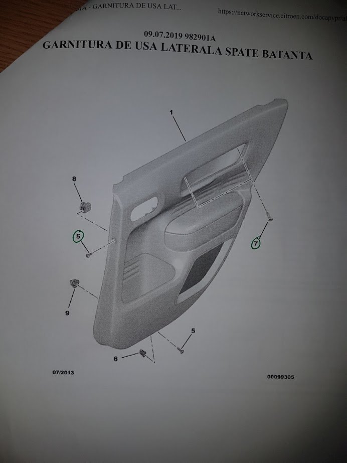

Hello,
After installing some speakers in the back doors, the guys at the workshop forgot to replace a few screws. I don't know what they should look like, what size they are. I went to the local dealer to order them, but I didn'get my order for a month. I would like to look after them elsewhere.
Can you guys help me please with some pictures about those missing screws?
I attach a picture about the paper they gave me at the dealer. I have the 5 and 7 screws missing.

Hi, and welcome!
I think those screws are just self-tappers, and around 20mm length.
You should be able to pick some up almost anywhere, or an "assorted pack" form someone like Amazon.
They don't look to be anything very special, and are pretty much hidden.

The ones marked (7) on your diagram are 22mm long and the ones marked(5) are 4.5 diameter x 19mm

Do you maybe know the type of thread on screw (5)?
I have a feeling that the thread is different on the two screws...

(7) is a CBLX and (5) is an RLX. So (7) is a self-tapper, but I have no more detail than that.
