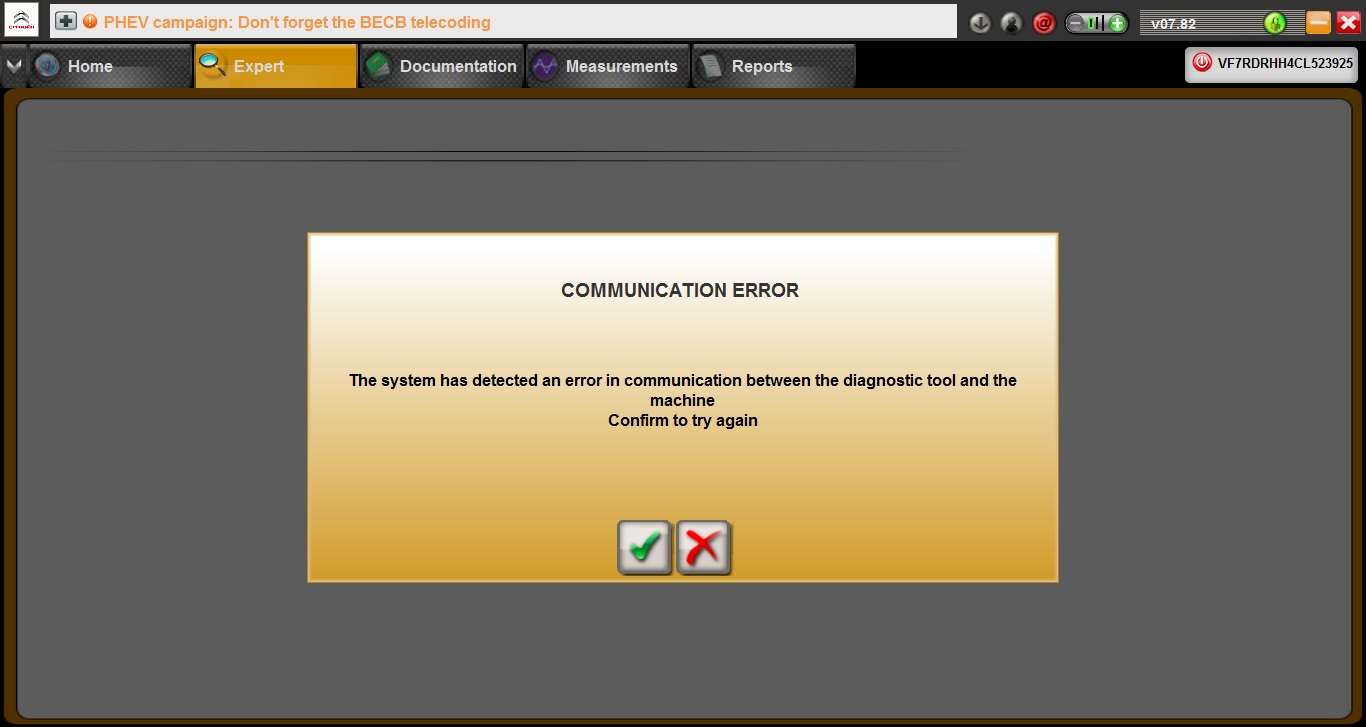

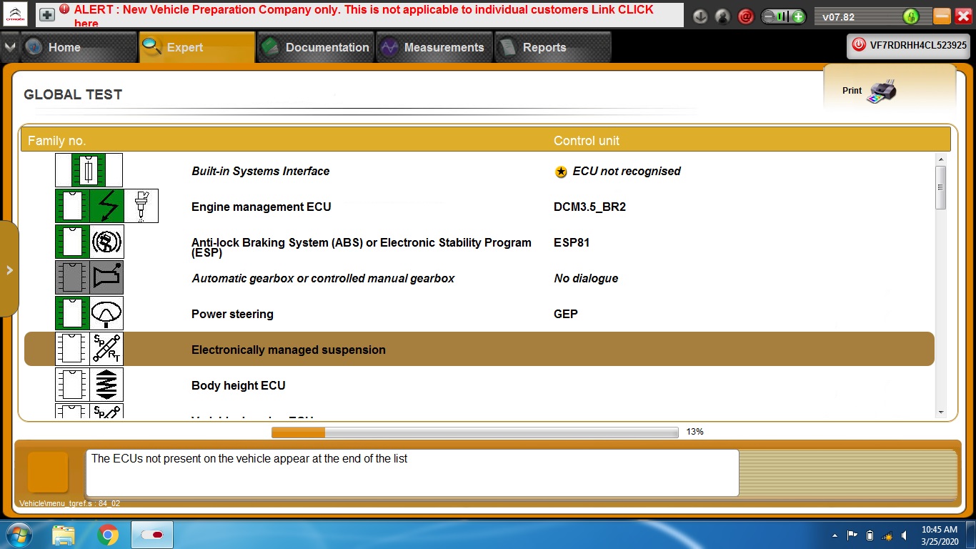

The long short story is when I connect for the first time the diagbox to car is working but further the connection is dropping in a strange way because some ecu's are seen and some not until I get the error to connect e VCI.
There is a compatibility issue for some laptops or for some chipsets? because I don't remember how many times I reinstalled diagbox/windows and still is not working.
Some screenshots with the errors. In the first screen the BSI is not recognized.

Today when I connected the clone to the car the message with successfully driver installed has appeared. I started the diagobx but the same behavior, VIN is not seen and when is seen not all the ECU's are recognized.
