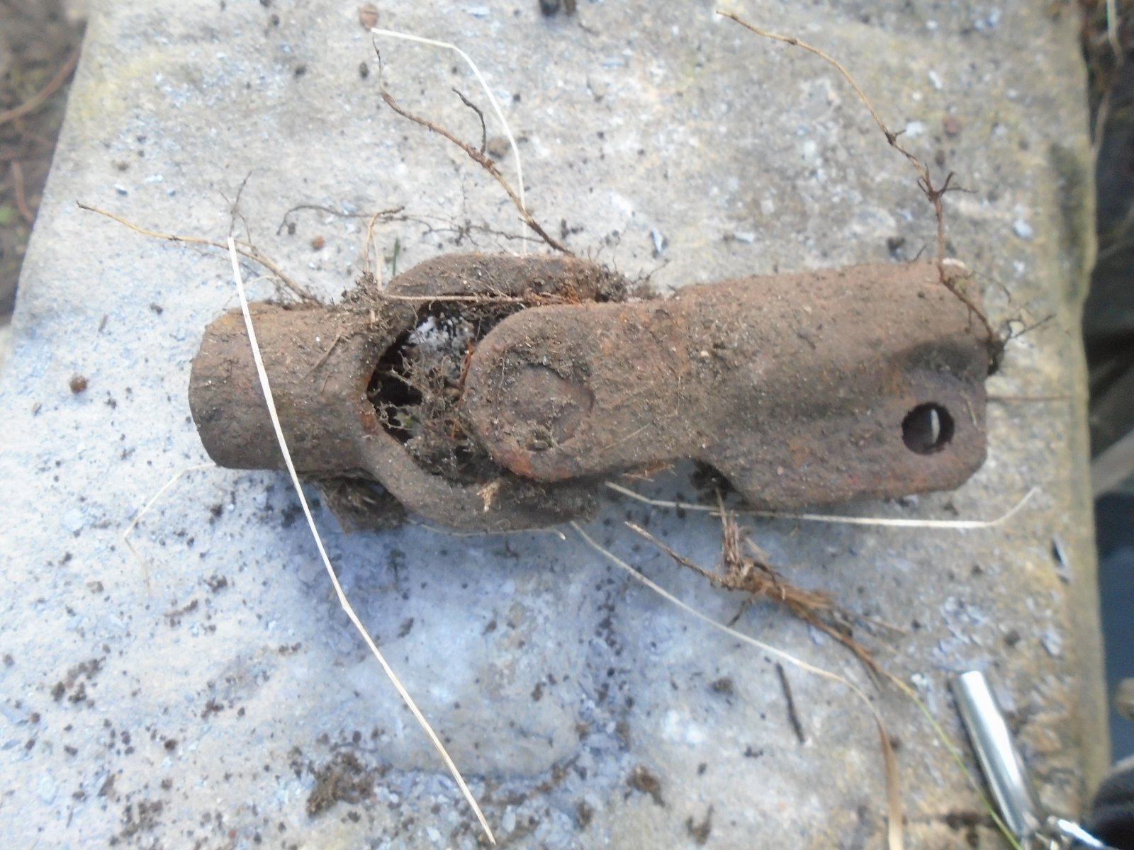

Well done Pete. My two Xantias got taken away by Elvis some years ago now (not the bloke from down the chip shpo but our local scrapman!). This remnant did turn up just the other day when I was planting a rosepeter306 wrote: 04 Mar 2020, 13:38 After a new Cat, new passenger side rear bearings and a bit of welding my 20 year old bog standard Xantia is good for another year. Replaced the Hub on the rear as Eurocarparts had a good deal, £15 for a brand new hub with bearings.![]()
