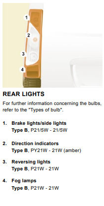

The manual states that the reversing lights are above the fog lights - as opposed to some vehicles having a Fog light on one side and a single reversing light on the other.
That being the case I would expect there to be 2 fog lights - one on either side. Are you positive it only has one?

Apparently it has one. When I checked servicebox it only showed one rear cluster in the picture (rhs) with all the bulbs and gave a part no for left and right. So I guessed the same as you. What servicebox normally states is whether if has one or two rear fogs, or a central one, it doesn't even mention rear fogs? It's either got one or a bulb gone? The van should be with me to check in 3 weeks.

Check the bulbs Pete, - the electrical diagrams refer to 2 rear fogs and service only shows 1 left and 1 right cluster - not 4, which they would have to do if there was a LHD version.

Cheers Marc, I was thinking along the same lines, a lot less grief if we're right.
