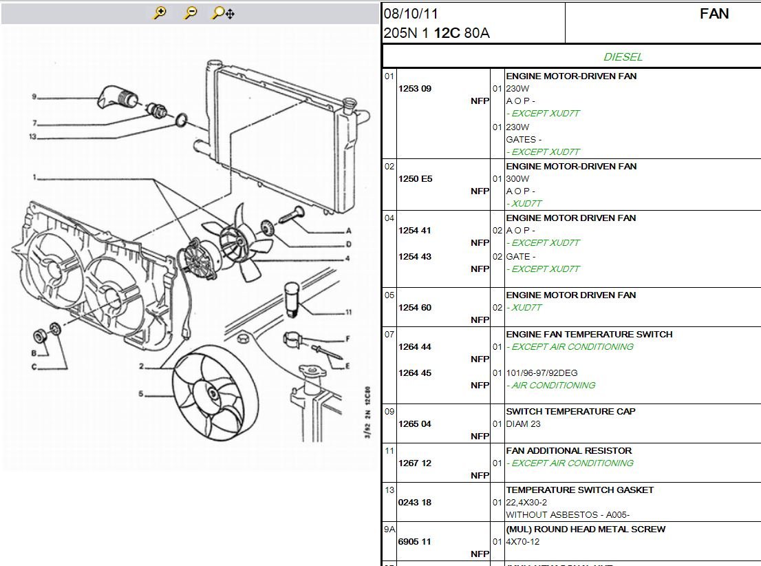

Right, have checked out vehicle details with your VIN.
Engine details are a bit sparse, just says XUD7, with (unfortunately) no more detail.
Cooling system parts diagram for the car comes up thus...
? Click to enlarge
Can you confirm
- is the car turbo or not?
- does it have one fan + the fan additional resistor (#11) ? Or two fans ?
- is there a thermo-switch (#7) in the side of the radiator?
The fan coming on after 3-5 miles of driving may not be abnormal, especially after driving at normal speeds, and then coming into slow traffic or stopping. 3-5 miles is more than enough to get a car up to full working temperature.
After the fan has come on, how long does it stay on for? Does it go off again if you pick up road speed, and air is being pushed through the radiator? If you drive at a steady 50-70mph on level road, does the fan ever come on while doing this?

white exec wrote: 11 Mar 2020, 16:09
Can you confirm
-its not a turbo :cry:
-its got 2 fans, they seem to have two speeds, can't remember an additional resistor
-as for thermo-switch (#7) it has something there, it looks to be a switch but has no wires going to it, (like a garage has fitted it as a bung)
don't have the car here to check everything (wifes at work)
but ill check later and give you definitive information
