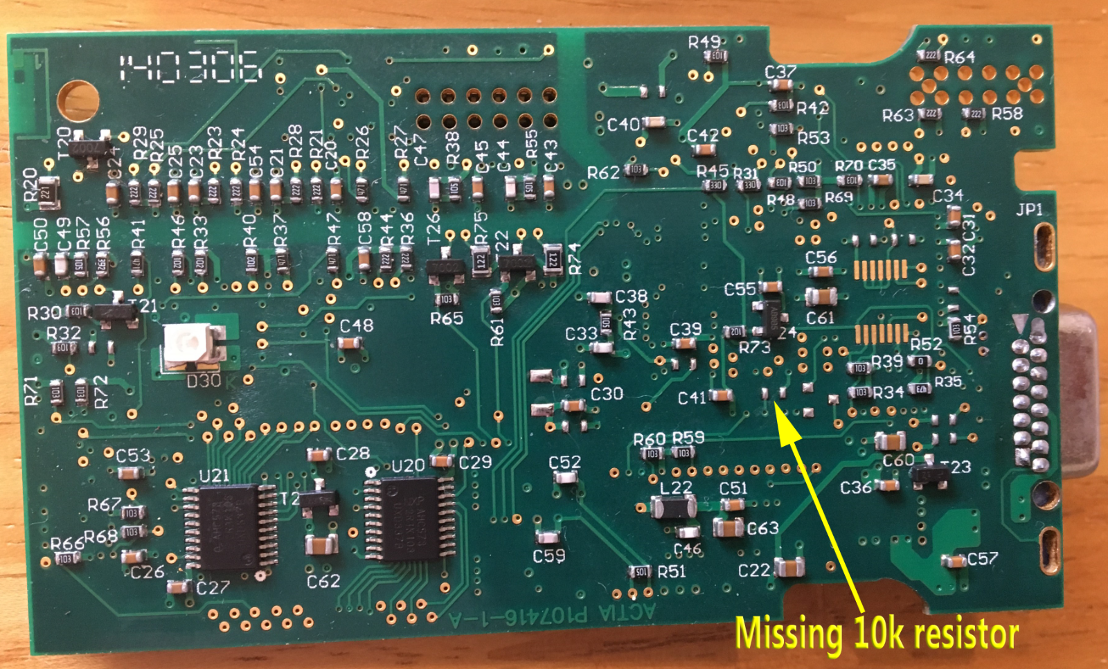

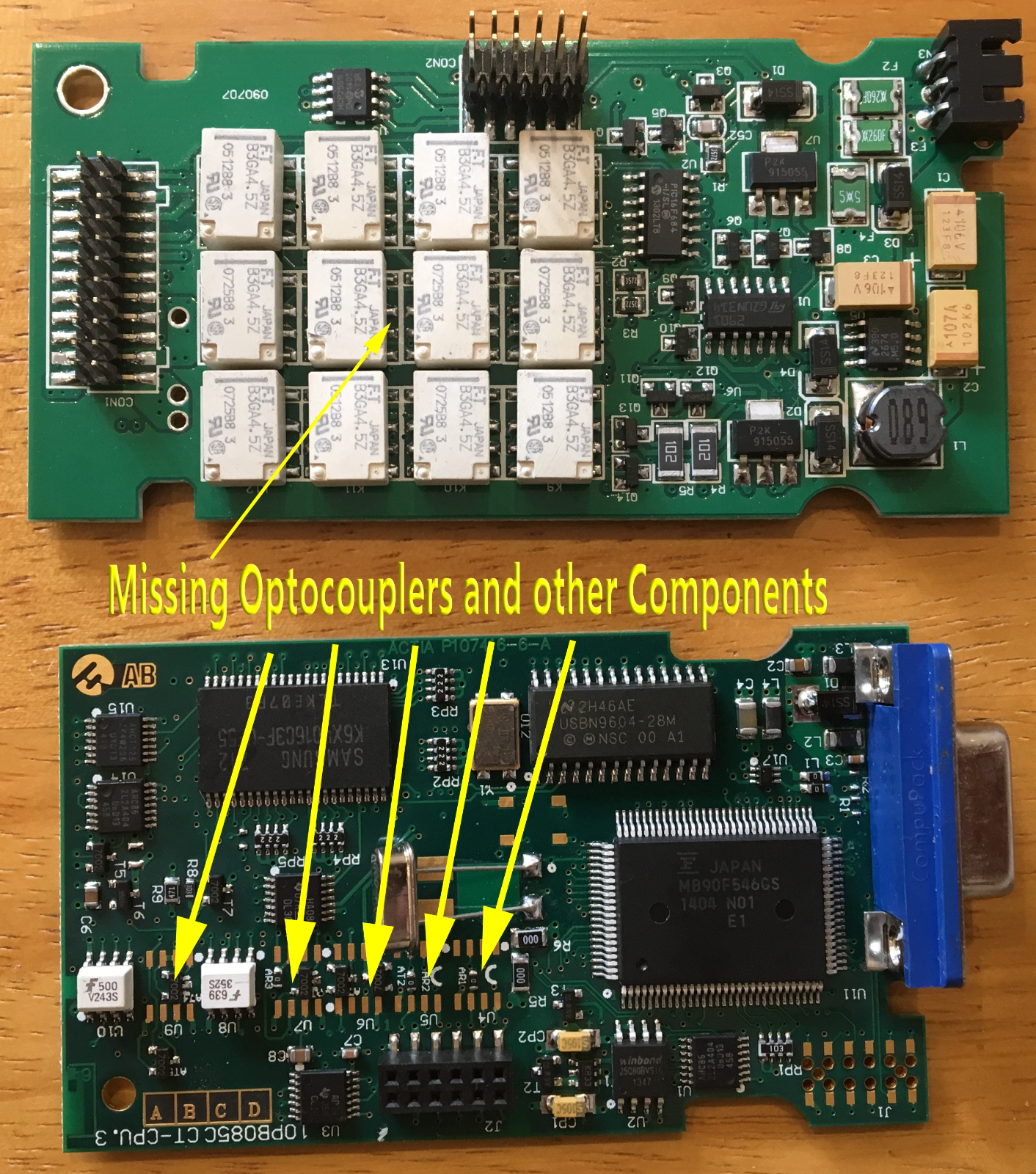

Roger, as per the pics you sent of your board, I've marked here the most obvious components missing:
This is a revision 'B' unit, and flashing this will make no difference as it is missing the hardware. You won't be able to use it on more modern vehicles and on those with CAN interfaces, you may get little to no communication - it depends on the vehicle and architecture.
The clone sellers offer cheaper kits for older cars and these are obviously at the cheaper end of the market.
Anything under £90 should be properly checked for quality and that it has all the components. Look in descriptions for anything that mentions if won't work well or at all with the Peugeot 308 or Citroen C5 - that can be a good pointer to avoid those completely.
Currently, if you were to get your interface working you would only really be able to run Diagbox V5 realistically on Revision B non-full chip kits.
