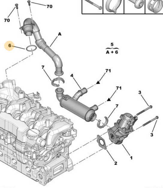

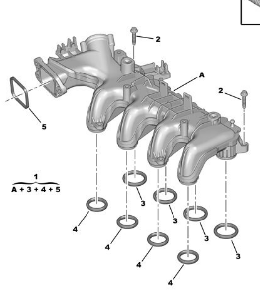

Are you talking about the air intake manifold?
Benscab123
- Posts: 158
- Joined: 09 Jul 2019, 20:33
- x 3

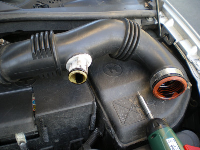

Re: Breather o ring part number please
No Marc, it’s in the middle of the pipe with the orange flange and connects to the pcv via a white plastic connector, I’m not even sure the seal can be purchased without the whole pipe.
- x 6955
You've lost me - are you talking about the gas recycling circuit? If not this, then i suggest you take a picture as the PSA terminology is different to what you are using I suspect.
O ring is on the white plastic part in the middle of this pipe.

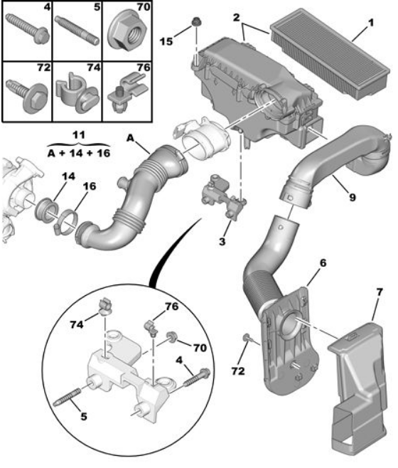

Hallelujah
That's the air filter piping. So no 'O' rings shown on parts for these, so I think you're going to have to measure the diameter and thickness and get one independently.
- Posts: 12566
- x 1485
Not shown separately
Should be easy enough to measure and just buy a ring the right size - alternatively, pretty sure I just wrapped a couple of turns of PTFE tape around mine when it was leaking which sorted it out...
Just as Marc said as I was typing....
