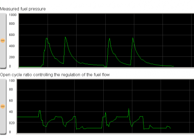

After putting back the starter I checked the car again:
  • the cambelt is intact however Diagbox trace shows "no synchronization"
  • running actuator test on fuel pressure regulator relay when holding my hand on the relay I was able to feel clicks roughly one every second (not sure if it should vibrate or just produce those clicks)
  • the cranking still cuts off after about 3 seconds evry time
  • fuel pressure goes upto 600 and then cranking cuts off. If Ignition is not turned off completely, during the second crancing pressure goes upto 600 again and cranking cuts off, however, after that if ignition is not completely turned off, the pressure doesn't go up again, but the cranking cuts off in abaout 3 seconds anywa. In the trace attached you can see 7 crankings: fuel pressure goes up in the first two and then the pressure doesnt go up on the third one, after the third cranking the ignition was turnd off and turned on again and 4 more crankings were made - you can see the the first 2 pressure spikes and the 2 last cranking did not produce any pressure spikes

tom_ely wrote:
26 Feb 2020, 16:48
It will not start injection if there is no synch so this is where the problem lies. I suspect the stop in cranking is because the rail pressure has reached a high level but it can't see the cam and crank in sych so it has not started injection so it stops cranking to prevent a rail burst. So either the cam sensor is loose and not picking the cam up, or the sensor has had it, or it is telling the truth and the cam belt has jumped a tooth or two.
There's a mistake in your VIN so I can't find it. It could be either a 16V or an 8V version at that age. The sensors are different:
Part Number Description Price excl. VAT Price incl. VAT Total incl. VAT
00001920QN SENSOR 38.73 GBP 46.48 GBP 46.48 GBP (16V)
00001920QZ SENSOR 29.69 GBP 35.63 GBP 35.63 GBP (8V)
Both available much cheaper on e-bay!
I don't think you can see the cam speed in Diagbox, just whether it is synched or not. I would check it's not loose, then consider having the belt covers off and checking the timing - not all that easy on the 16V at least as the top cover is wrapped around the engine mount so you need to take that off to get the cover off.
Unfortunately AFAIK it ignores the cam signal once the engine is started, and this therefore points to the timing actually being out of synch since it stopped without warning....
