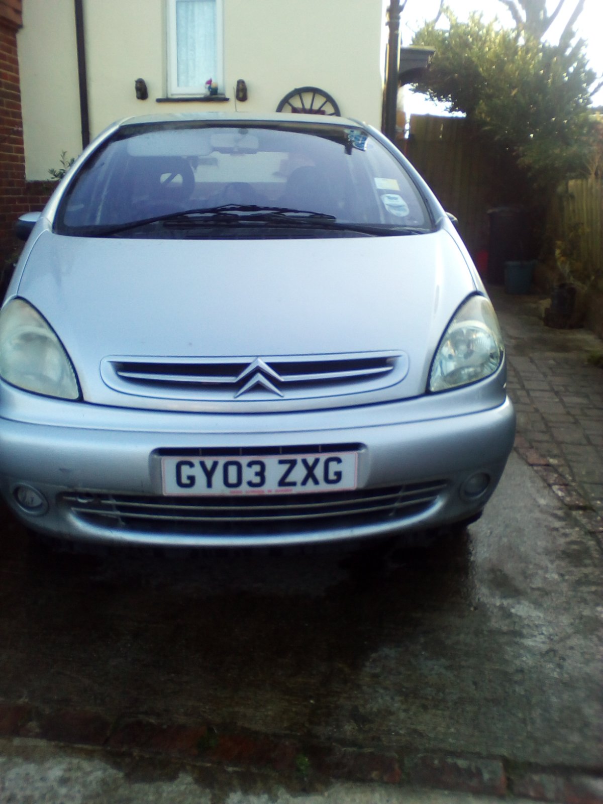

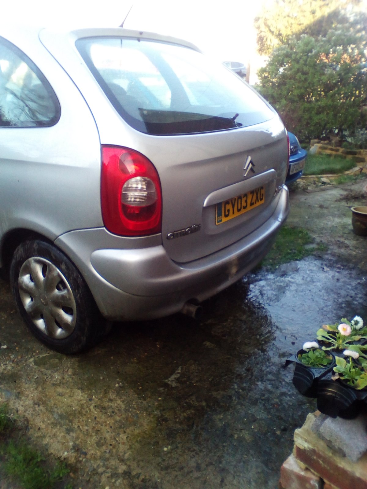

I now have a Picasso .
It was a good deal its an 03 plate with the 2.0hdi which after advice about the reliability of this engine its what i went for.
It drives nice and having a test drive last month in the 1.6hdi there is a noticeable difference between the two.
It has silly little jobs that need doing as follows
A good deep clean to the inside
Number plate bulbs don't work so will need replacing.
All but one door locks , there's a pulse in the loom but not sure if the locking part has either come unplugged or packed up altogether.
I need to figure out how to remove the rear door card fingers crossed it won't be to hard .
The cambelt was replaced complete kit by Tate's about 35000 miles back, its mainly done motor way miles and is on a tad over 168.000 milles.

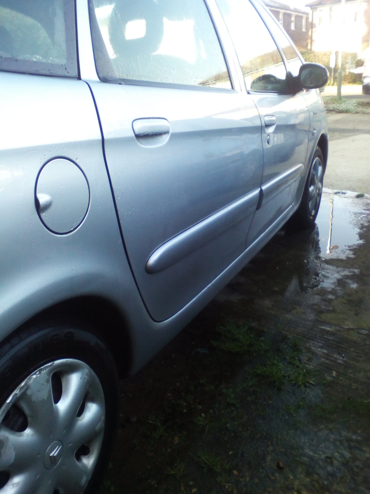

Its had the sills plated by a professional and it shows nice and neat .
I'm hoping to tackle the locking issue today
And once the weather warms up a very deep clean of the whole car too.

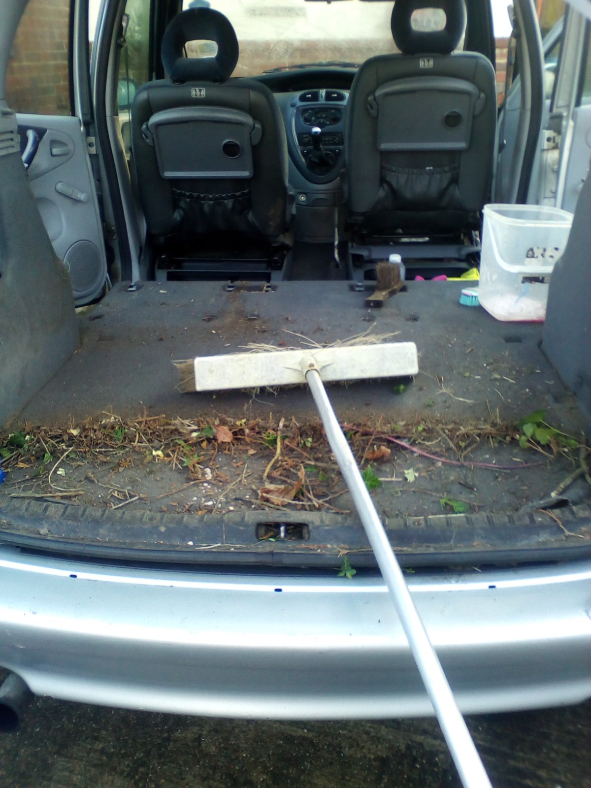

Thanks , A Lot cleaner now i deep cleaned The whole
Interior took most of Saturday just past to do, I'm surprised how smooth these are for a bigger car.
Slowly sorting out age related niggles aswell
