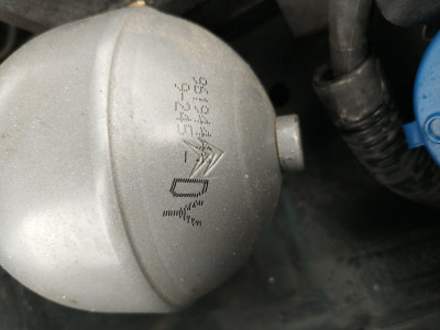

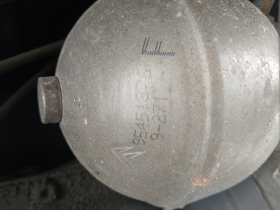

Added are some photos of my front spheres, I've tried to check the part numbers online without much luck. Any help identifying what I need, or matching comfort spheres would be great!

So from your VIN you have a XANTIA 5 DOOR SALOON 2.0 i (XU10J2) Manual gearbox 5 without active suspension and fitted originally with UREPAN front corner and accumulator spheres.
The first picture is a Front sphere for a 1.8 Petrol - which have 70 Bar pressure (too high).
The second picture is for a Urepan Membrane, part: 95451376 (correct pressure), but you could also have a Desmopan membrane (see below)
The Front Corner spheres should be part: 96178589 400 CC Volume and 55 Bar Pressure.
The Rear Corner spheres should be: part: 96178590 400 CC Volume and 30 Bar Pressure
The main pressure Accumulator sphere is part: 96154588, 400 CC Volume and 62 Bar Pressure for a Desmopan membrane.
