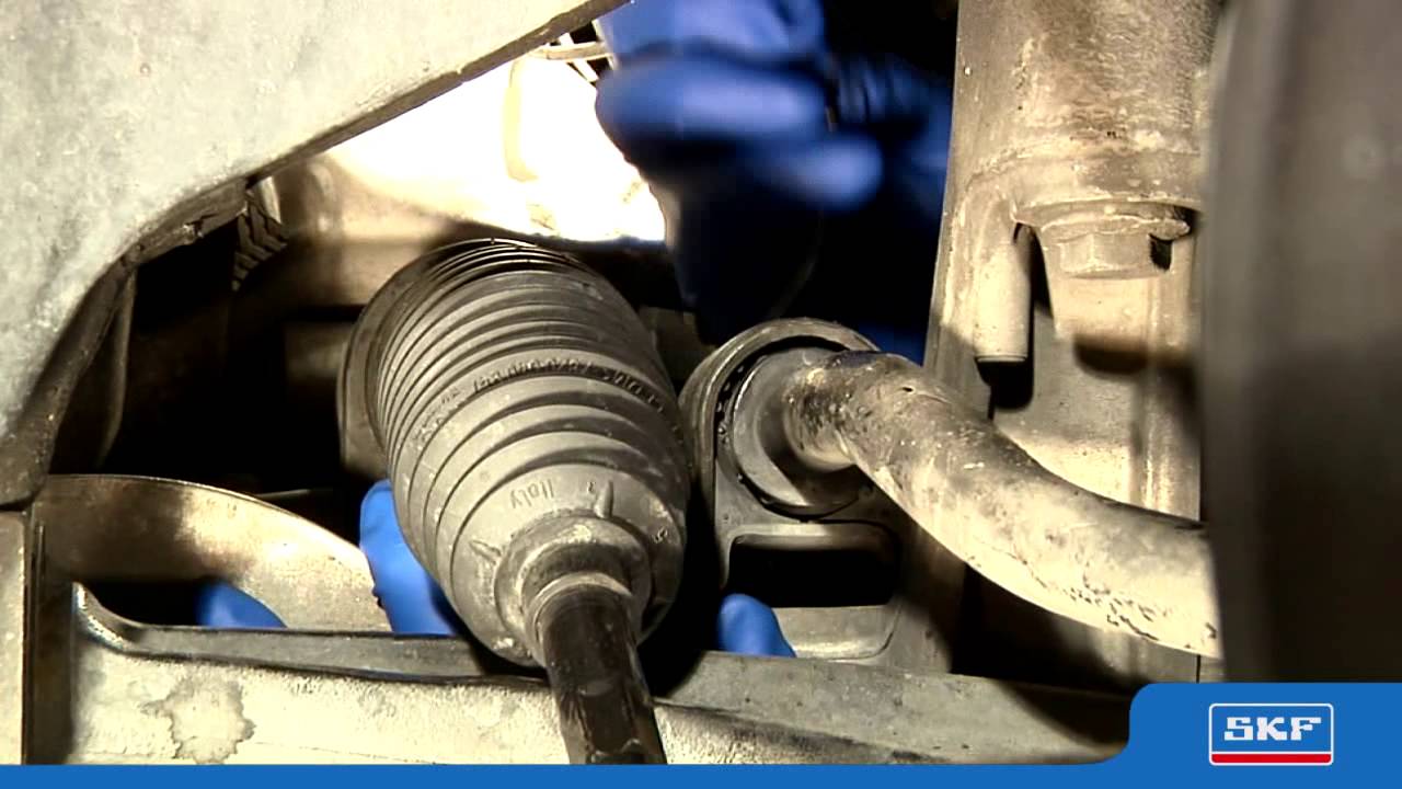

Does this happen mainly when turning the wheel from lock to lock?
I had a problem where my track rod gaiters had turned oval (not round) and caught on the subframe as I turned the wheel.

Re: Loud Popping Sound While Reversing
I would double check the steering boot is nice and round and not catching on anything when being turned from lock to lock.
Here's what a good one should look like:
My one looked like an oval and would give an audible 'pop' as it deformed when hitting the subframe etc.
Zulhilmi
