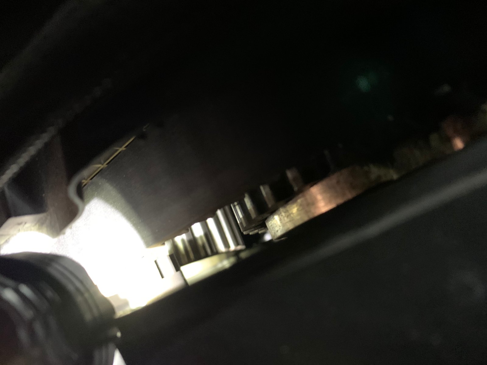

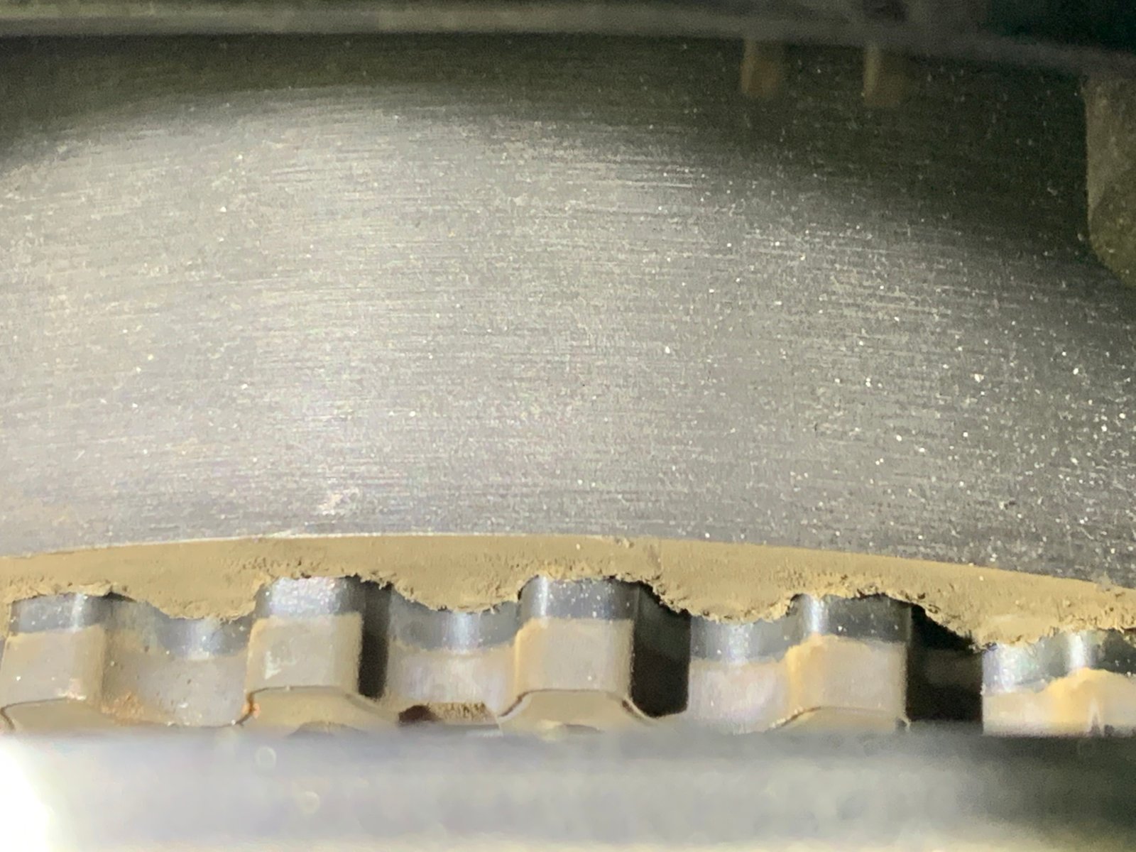

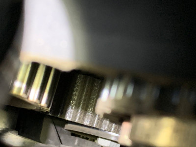

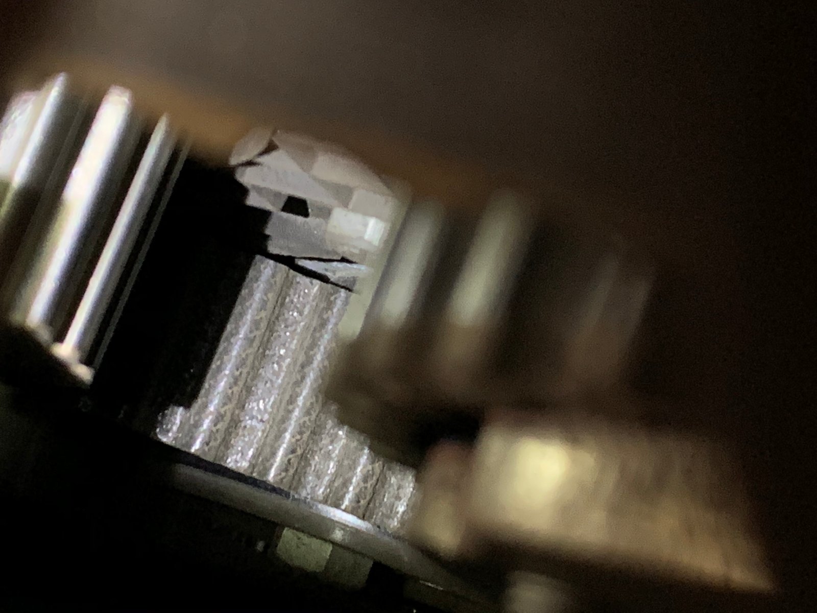

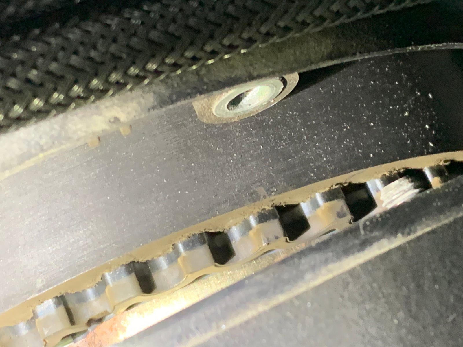

Hello, i need your opinion about my timing belt status.
I've bought this used Peugeot, but the seller doesn't know if the timing belt was replaced on the last service.
So, before i start disassembly my car, i've opened the cover and tried to take some pictures of the actual timing belt, both sides.
I'm sorry for the pictures but it was not easy to use the light on one hand and the phone on the other end, and i've tried to zoom it as best as i can.
To my opinion it looks good, i don't see cracks on the belt, what's your expert opinion ? Should i change it or not ?
The car has 170'000km on his back, if i can make 10'000 or 20'000 before replacing the belt it's better for my bank account :)
thank you for your time and best regards
Dave

Although there doesn't seem to be any actual cracks, - the underside (tooth side) does look as though it is deteriorating (crumbling in spots) in photos 2,3 & 4 when magnified up.
What you might consider expensive now will be nothing compared to what can happen if it does break. But it doesn't look like it is too old from the images at this stage, so it's whether you want peace of mind in the knowledge that you've had it done.

Looking at the polishing on the sprocket, the belt has either been changed recently and is riding in a slightly different spot, or (more likely IMO especially given the noise mentioned) one of the pulleys/tensioners is wearing and the belt has started to run out of line & chafe against something.
If it were my car, I'd be changing the belt as a matter of priority considering the mileage. Would also like to ask the opinion of the other guys here about how the belt is running, with particular reference to the photos I've re-attached below, first one being the shiny mark on the cam pulley where it's been running for some time previously until recently, and the second which appears to show a pulley with possibly a collapsing bearing, or at least to my eye it looks a bit skewed and again there's polished metal where the belt has run but is not running now.
Main thing that concerns me is the mention of noise from the timing belt area & the fact that it appears to be running further back on the pulleys than it should. Hopefully I'm just being over-cautious, but a new kit is cheap insurance in the long run.
