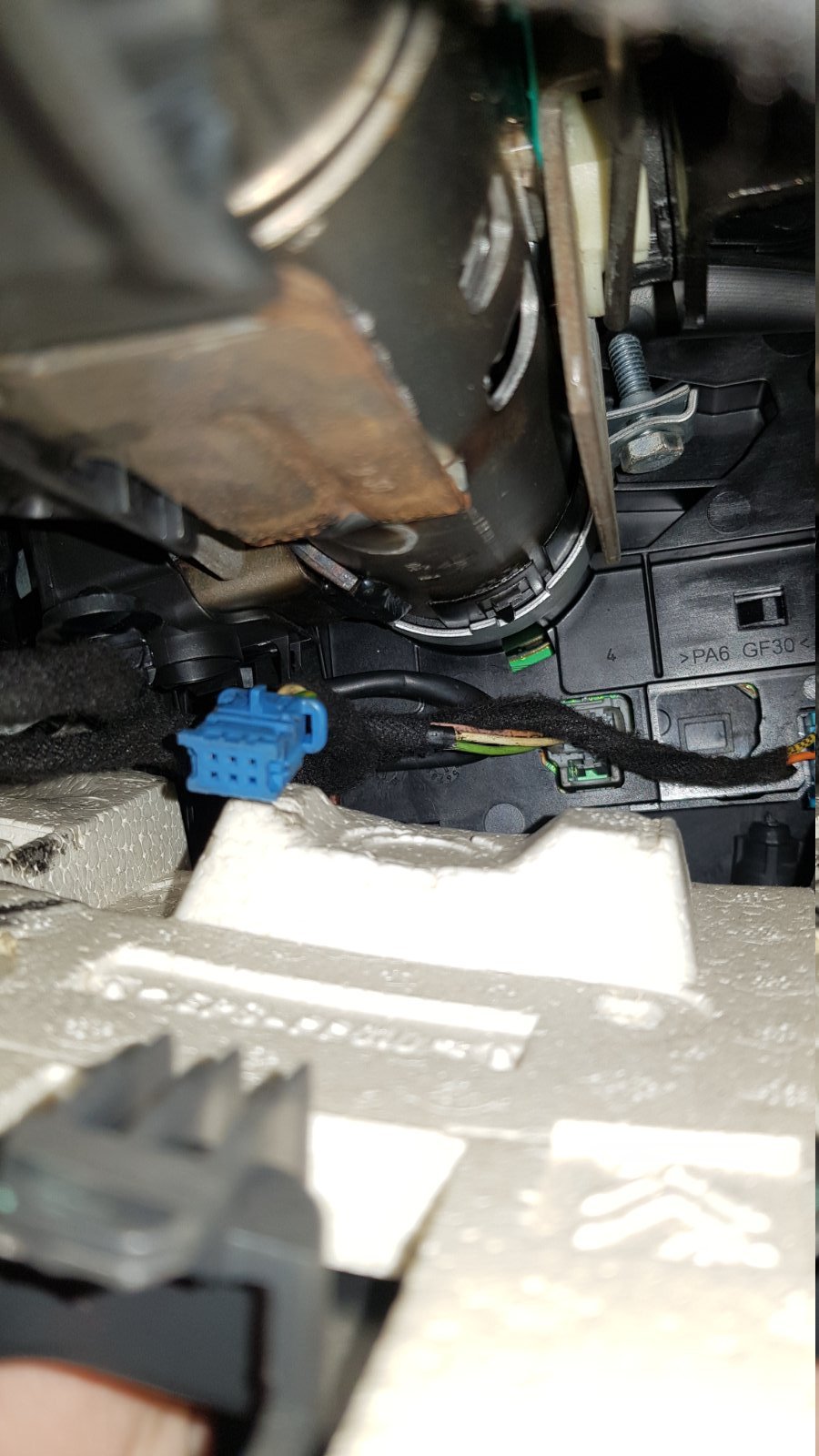

Hiya, have a question, hopefully you guys can help me. I recently bought a C3 2009 exclusive for my partner. Before we bought it the rear wiper part on the stalk was broken which they replaced with a complete new unit (indicator stalk, wiper stalk and stereo control) however now the rear wiper works, but when you pull on the wiper lever nothing happens at all. I contacted the garage and they said that the garage had to 'modify' the control so now the front windscreen wash works on the rear window wash control, so obviously there's no rear wash either now. The garage have said that they will book the car into an auto electrics place for them to have a look. When I took the lower trim off from under the steering wheel I noticed two small plugs that weren't connected to anything at all. I'm just wondering if anyone knows what these two plugs might be and also e there is anything simple that I can look for to try and fix the problem for my partner in the meantime.

A pic of the plugs would help identify what they are.

I'll try get some pics up of the plugs either later on or tomorrow. Tbh I've no idea why they had to modify it, it could be that they forgot to plug something in somewhere, no idea I'm afraid!

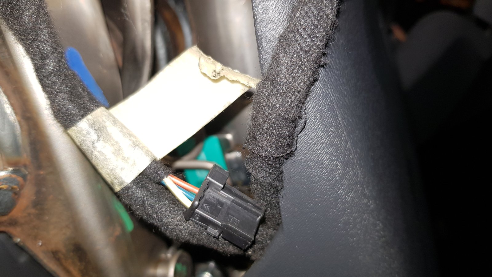

I can't see anything obvious apart from the ignition wiring which is a 3 pin black socket - but obviously not that, or it wouldn't start.
In your picture there is a label. If you can get the info or a picture of that it might help me identify the harness. The wires themselves often have a code (usually up to 4 numbers or 4 numbers and a letter) on the sleeve somewhere along. That would enable me to identify the wire quite quickly.
However, going back to what Wheeler said - I entirely agree that there should of been no reason to modify anything - if they had the correct part in the first place. The correct part for the steering wheel control module was: 624340, now superseded by part number: 96773879ZD. This is for the C3 VIN ending in 135.

Cheers for that mate, that version has a cruise control selector underneath the indicator stalk, does that mean that cruise control is plug and play on her car, as the old one plus her new one doesn't have it.
I'll try get a pic of the label for you now, hopefully the wording etc hasn't faded too much.
Also, cheers for all the help from everyone, its really stressing her out, and I want it to be as perfect as possible for her
Also, I'm positive there is another plug loose, but that's underneath the steering wheel casing, so I'll try get at that one again tomorrow sometime, although I'm sure that it wasn't a black one

Re: C3 front wiper wash
It should be rotated clockwise for the correct way the photo was taken lol
