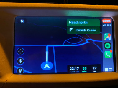

Hi there,
I’ve got a problem with my DS3 screen but only inside Apple CarPlay which leads me to think it is a software issue. I got it diagnosed by Arnold Clark but I don’t trust it very much at this point as they said the unit was damaged... how, if it works fine for everything else (apart from sensors, of course...)? They said 700 for replacement with a new one... but I can’t see that being the problem.
My phone is an iPhone 11 but when I tried it in a C3 cactus 2019 courtesy car last time the issue wasn’t present, it displayed everything correctly without cutting off the bottom.

The update you have is, I believe, the lat update for this system. The SMEG systems have now been dumped in favour of the NAC systems, so unlikely they will be updating the SMEG units anymore.
As for your problem, this has affected several users, but no there are no solutions I am aware of. Did you perform the last firmware upgrade yourself? Have you not noticed this before?

No that’s a bit of bull to be honest and a typical response. The screen cannot suddenly change the resolution of the image. It gets the data from the SMEG unit. So can you answer my question as to has this always been displayed like this since you have had it or only after your map update?
The reason I ask is that this has almost 100% happened after a firmware update. Yours is a 2016 model (probably built even earlier) and that firmware was only released in 2017. I can tell you the exact build date if you pop your VIN up.
So this has likely happened after the last firmware update or map update.

Ok so no, you cannot downgrade a firmware - not possible.
So it's a known fact that when you update to certain firmware versions, sou must get it calibrated at a dealer. They will need to connect to the PSA servers to correct certain issues and cure some of the problems that result from updating to major firmware. They will charge you a diagnostic fee to do this of about £90, but the ECU will generally be locked in secure mode, so can't really be done by Diagbox in offline mode.
There's no other solution with these - other problems can be incorrect logo, poor radio reception, echo on hands free, missing radio bands, issues with parking assistance etc.

It may be the newer IOS software that could be causing the screen size issue - with the older SMEG systems that used smaller screens than the later units. It's really difficult to pin point the issue given the hardware and software of the Head Unit in the car and Apple's Software that is constantly being updated.
One of the OPs that had this issue said the problem disappeared when trying the same phone on a later 2019 Cactus which would of had the NAC system. These are the later systems, much improved and with larger displays. I have none of these issues with Carplay on my Aircross that also uses the later systems. So I suspect it may be a problem specific to the SMEG units coupled with the Apple updates.
