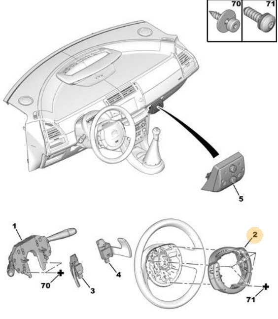

Re: C4 Steering Wheel Controls
Which module did you replace Steve?
(1) or (2)?
(1) or (2)?
Steve Walsh
- Posts: 774
- Joined: 25 Oct 2019, 07:20
- x 515
Replaced Number 1 a while ago to cure headlights not always clicking onto main beam, Yesterday replaced number 2
- x 6954
Ok, so the reason I asked, is that if you are replacing the 'Steering Wheel Control Unit' item (1). then you need to check the BSI software version using Lexia / Diagbox.
If the BSI software version is 07.3x, then the BSI must be updated to 09.x which is the latest version. This will be a dealer - only job as the download will come from PSA servers. This is usually to ensure that the BSI and the Comms Unit care compatible when replaced. This is noted as part of the procedure when replacing the comms unit (1) Steve.
Ok, so my next question is, what part number did you order for item 2? There are a load of these - if you get the wrong one it won't play nice.

- x 6954
Ol, there is a superseded part number (98003833ZD) now for these. But I suspect if the fault existed before and still does then the issue may lie elsewhere.
I shall have a look at the diagrams shortly
Can't see anything specific to the unit - all the associated functions (Audio, Horn etc.) have their own diagrams but very little on this unit. So could be a data wiring issue from the unit back to the BSI. Double check the connectors as these are notoriously sensitive.
