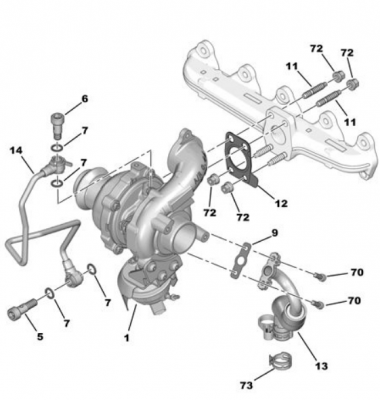

Hi, Can anyone confirm if the 2016 1.6blue HDI , still has the filter in the turbo oil pipes. I'm sure iv seen on here that peugeot removed them at one point but can't find the post anymore. Does anyone have access to peugeot parts system putting my vin number in should show on a parts diagram if it's fitted or not?
I dont want to remove the cat ect to gain access to find it dosent have one.

This is a 2016 DV6FC model - completely different than earlier models. There is no modification to the banjo bolt listed - so has been engineered in from the beginning, if it was ever an issue on this specific engine.
It probably already has the new larger versions.
