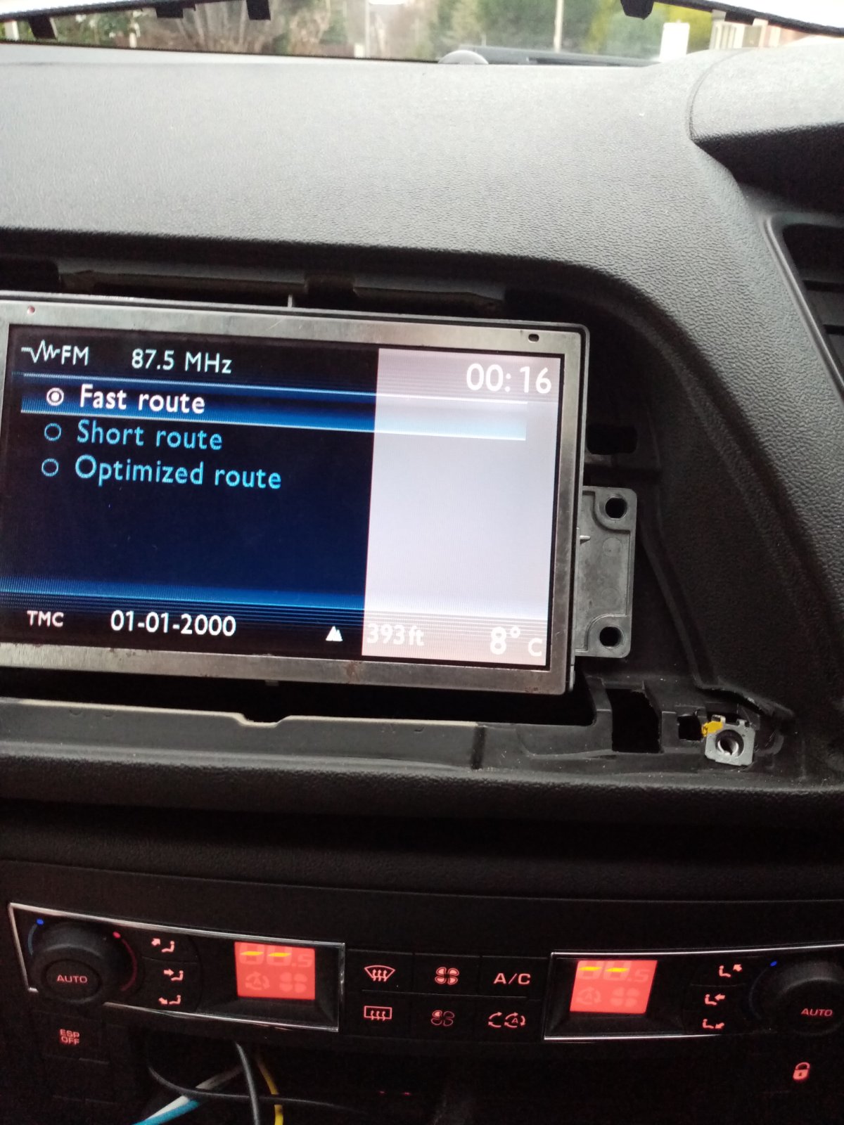

The unit does have the SD card in the front
Could it be the data cable?
The unit and screen were removed from the same car
Regards
Steve

- x 6956
Re: Sat nav
Ok, so if they were working as a pair they should be fine.
One thing that can brick the display is if you do not remove the quadlock connector first before the other cables and certainly before the LVDS cable that connects the screen. The Quadlock contains the power and if the multifunction screen cable is connected or removed whilst the quadlock is still connected, it can damage the display.
The Quadlock must always be removed first and connected last.

Re: Sat nav
Update
Managed to get another screen although not as tidy as the other (screen bezel) at least it works
