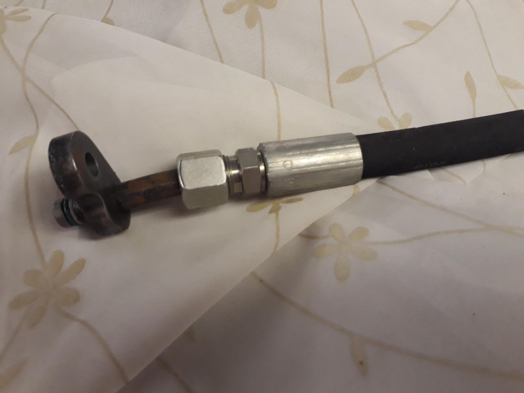

I had one repaired at a local hydraulics place.
The leak was at the ferule where the flexi joined the rigid pipe closest to the strut.
They basically replaced both ferules with a swaged joint and made up the difference with a slightly longer flexi.
I used the pipe with no issues for a few weeks then I got lucky and found a new pipe at the right price.

Mine was due to the bend in the pipe that was poorly made - the pipe was weakened during manufacturing and so wore through on the bend.
