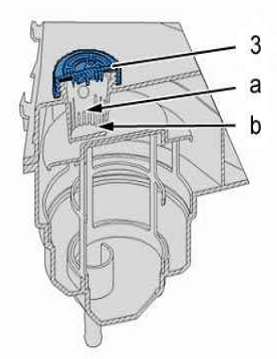

I would try raising the car to it's highest setting, then lowest setting a few times to 'exercise' the electrovalves, then leave her on the lowest setting (on flat ground), and unscrew the LDS fluid tank cap, then with the engine running, very slowly turn the wheel lock to lock 5 times. Check the LDS fluid level is between the marks 'a' & 'b' as shown below. Top up the LDS if necessary (only between A and B and only when the car is on the lowest suspension setting)!
Then return to normal setting, switch off and see if it sinks. This procedure will bleed the hydraulic system and get rid of any air locks and doesn't cost you anything. Failing this, further investigation may be necessary.
