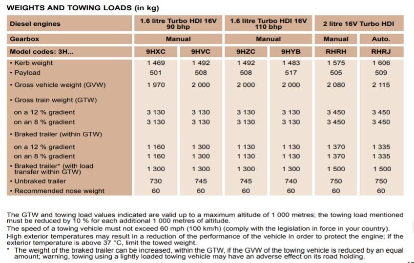

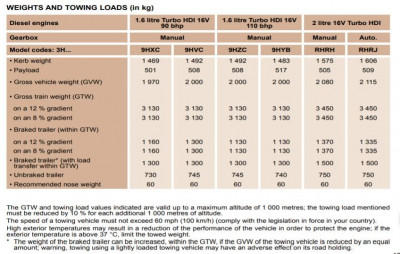

Towing info for the 307SW from 2006:
So the towing limit is pretty close to 85% anyway. 1130 kg should be OK for a 2 berth van. Noseweight is quite low at 60kg - don't be tempted to reduce the nose weight by putting weight in the back of the van - this just makes a perfect pendulum that will have an insatiable desire to snake! With a low nose weight you might need to re-locate the gas cylinders to the centre of the van over the axle - just make sure they are well secured. 307 has torsion bar rear suspension, so you can't fit spring assisters.
