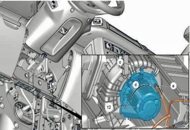

My next question is how is do you remove the blower motor?
It is very difficult to see any srews etc but I can feel one plastic lever that I have pulled on but motor still not shifting. Do you twist the motor and if so is it clockwise or anticlock wise?

- x 6945
Re: Citroen C5 MK3 1.6 THP 2012 Heater Blower not working
This image is for a left hand drive, so ignore the pedals shown (and be glad you actually have a RHD - as it otherwise would involve removing the accelerator pedal assemble and knee airbags!).
Disconnect the air blower (12) connector ( as "e").
Press the tongue ( as "c"); Turn the air blower (12) clockwise to disengage it from its retaining lugs (In the direction of the arrow "d").
Release the soundproofing under the fascia panel and around the air blower (12).
Remove the air blower (12).
Many thanks this is a great help.
