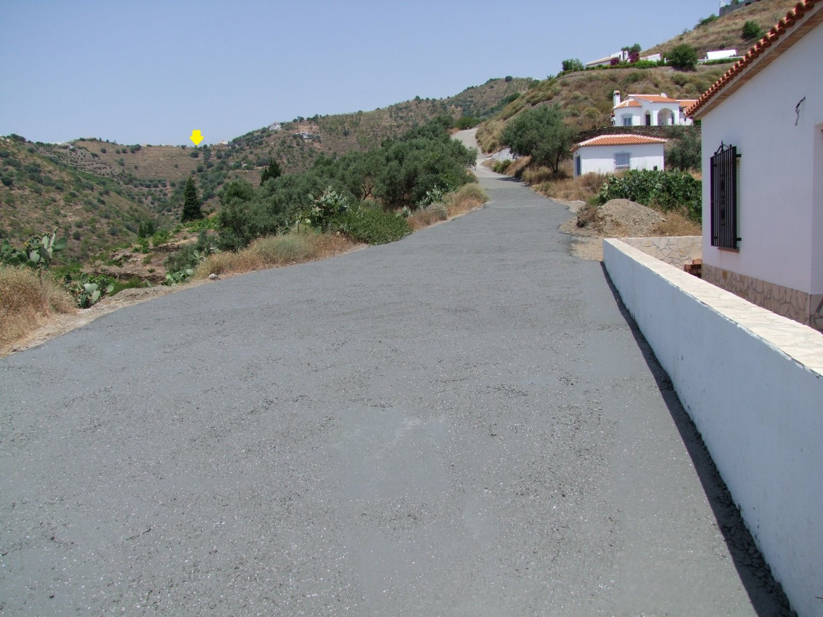

I don't get a lot of choice of gear when leaving home. Turn right out of the house towards of local village, and there's an immediate climb, rising 51m over 440m of single-track road (?12%, 1-in-8) - which we concreted in 2010.
This is second gear all the way, no choice.
After that, it levels out a bit, with the next 0.9km rising 73m (so ?8%, 1-in-12), but a good bit of it still curving dirt-track, so no chance of speed. Second gear all the way still.
At the top of the ridge (the yellow arrow), the track tips over a blind summit to a winding 2km sloping descent to the village, along concreted road, with only a brief part of it allowing 3rd gear.
So, 2nd gear gets plenty of use here, until you break out on to the tarmac'd two-lane mountain road that links Sayalonga village to coast. 6km of this, with just 300m offering a chance of 4th, so 3rd gear most of the way on this!
Thereafter, a decent 3km to the coast, with even some scope for 5th!
