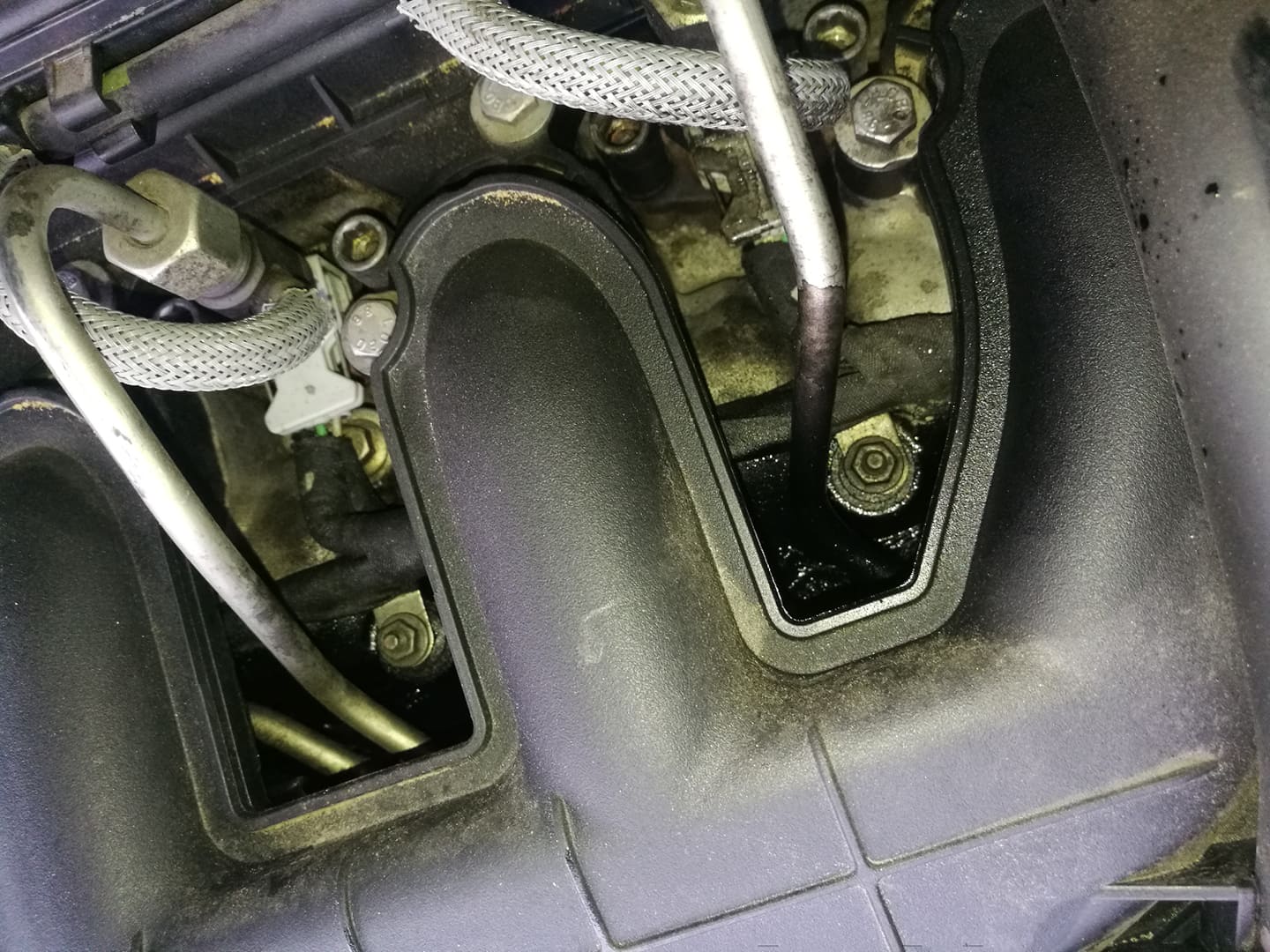

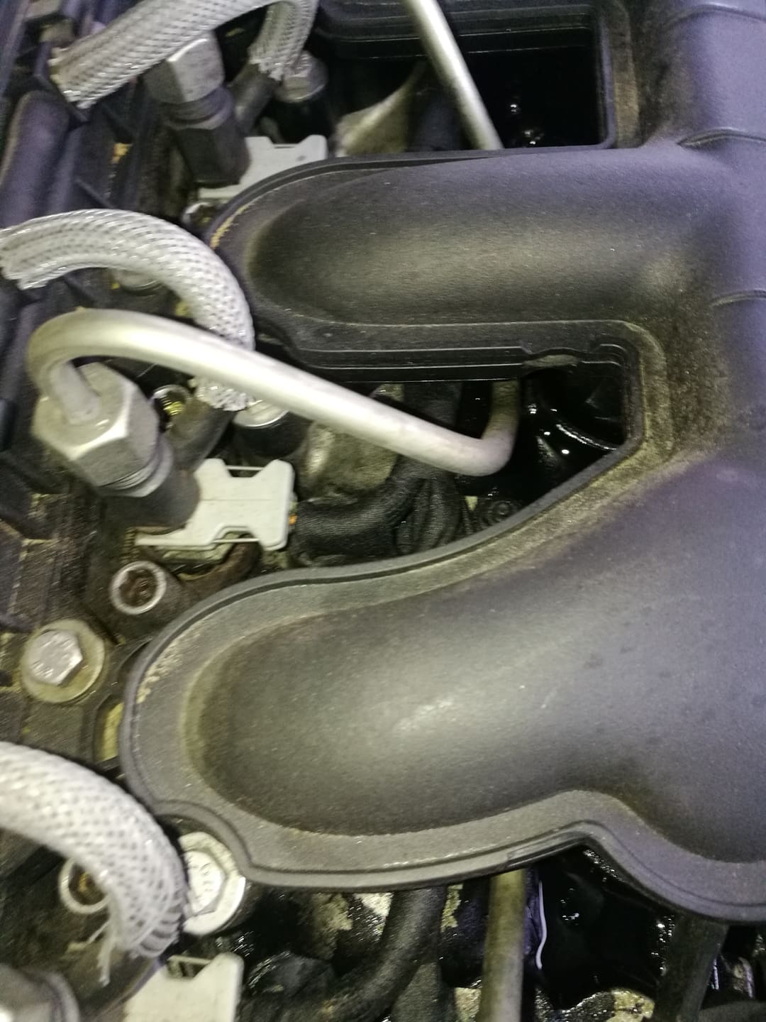

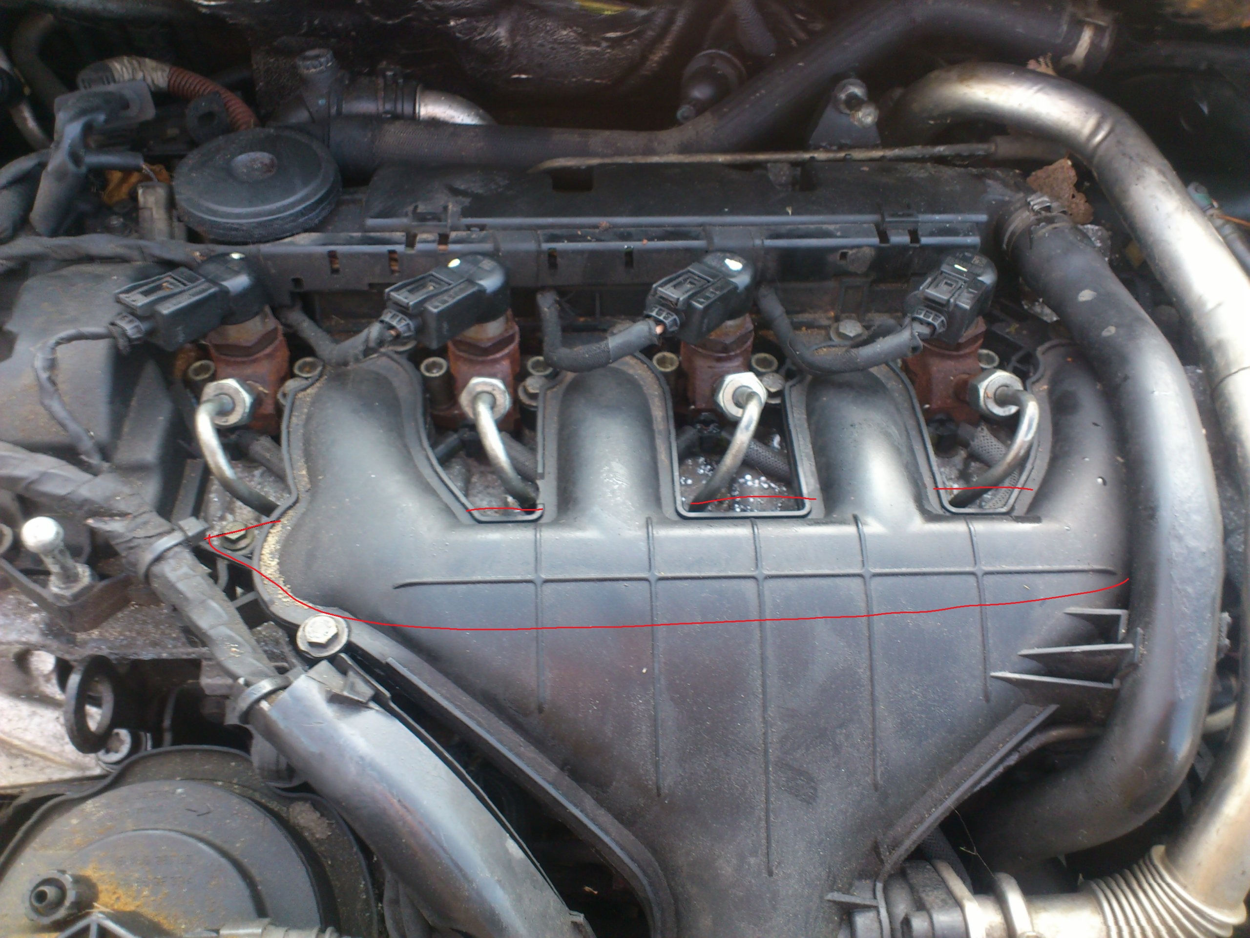

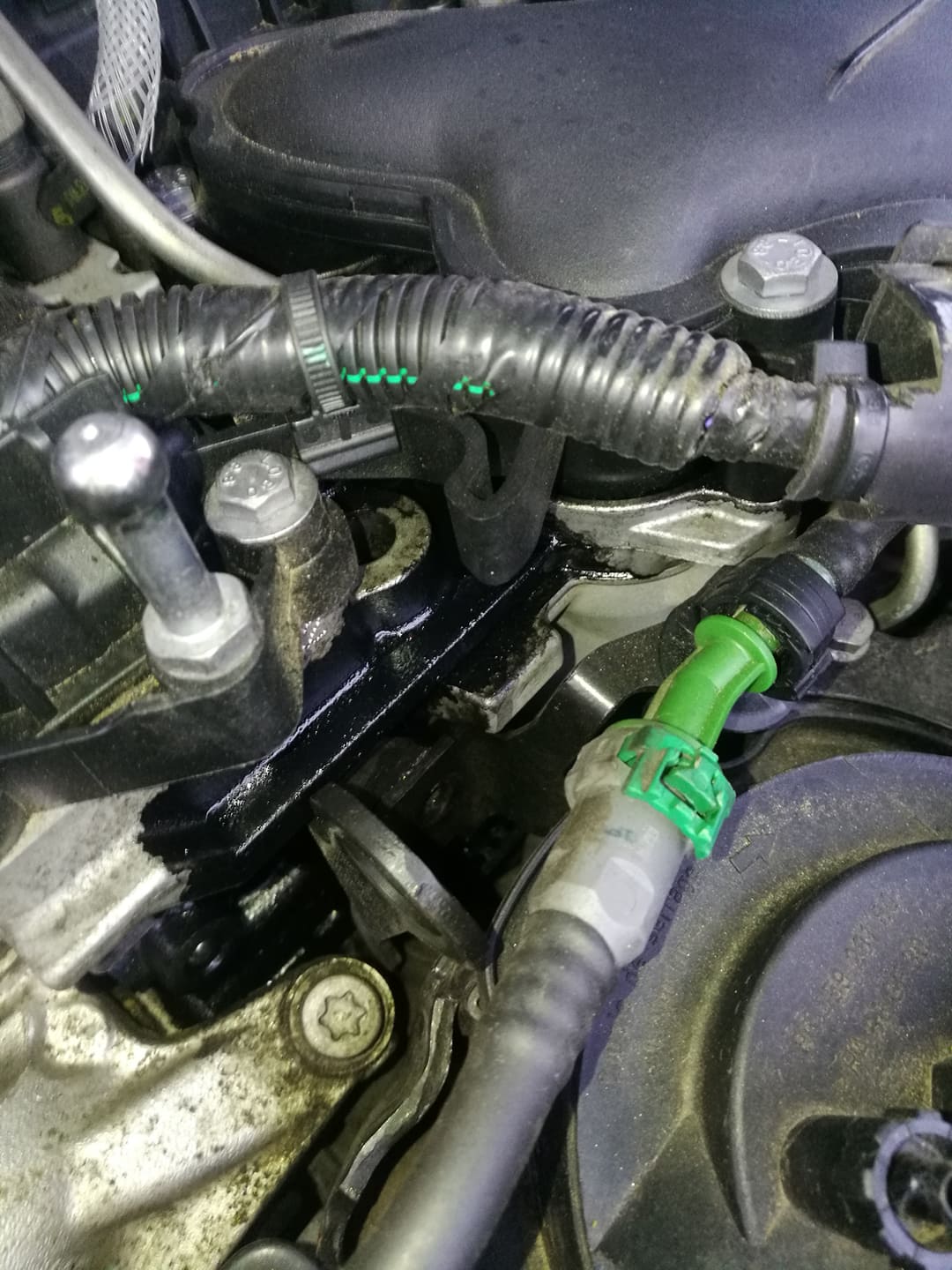

Today i saw my car is leaking oil, but can't see from where. It's leaking somewhere beneath the injectors, seems to be more oil towards the EGR piping. Any ideas? I'll attatch 3 of my pictures.
NOT MY PICTURE
It's oil below this intake piece that i highlighted in red in the picture i found online.

And here comes my own pictures.
Spoiler: show

Id give it a good clean with degreaser and steam then it should be easy to spot the leak

That would work you dont need very high pressure jut make sure it cant get into the intake system. Spray on the degreaser leave it 5 minutes then work it with the wife's toothbrush. when its clean a short drive of say 15 minutes should show you where the leak is

Once you have cleaned and dried the engine bay, try drawing horizontal lines on things using chalk. An oil leak will then be easier to track down.
