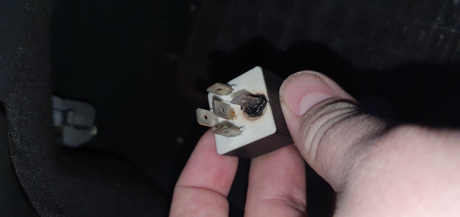

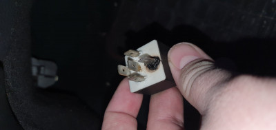

Re: Need advice, no dash lights/rear lights Xantia
Thanks for the help people, was for sure a relay! Omw to my local Citro dealer atm. It came on while tapping but as you can see it's due for a replacement....
Well found!
That's a standard 12v automotive 30/40A relay, available anywhere.
Check out any other "front end" relays for dirty/oxidised base contacts. Common problem, not least in wet/icy climates.
This one is a 25a one, dealer wanted ~50£ for a new one. I sourced a 30a at a cheaper store for 1.5£white exec wrote: 19 Dec 2019, 08:59 Well found!
All well for now!
No wonder people avoid the dealers.
- x 1746
Around £3 would be expensive enough, so well done for shopping elsewhere!
