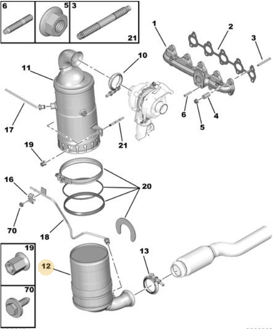

- x 6957
Re: 2010 C5 X7 risk of particle filter blocking
No, it's part of the catalytic converter assembly at the front manifold - CAT first, then DPF, item 12.
Thanks for adding the drawing, it doesn’t look like it’ll be too tricky to get out if required.
