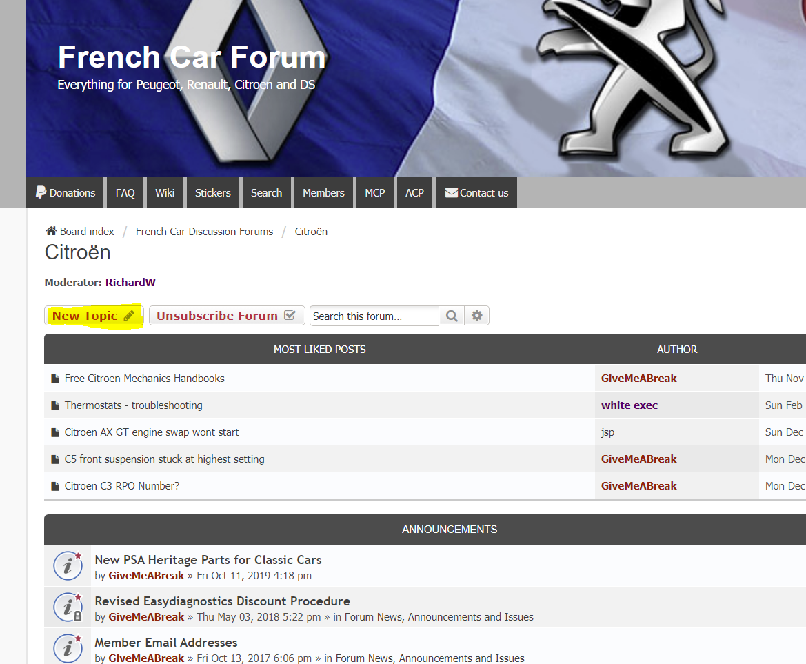

Simple: Select the appropriate Forum for your post, (Citroen, Peugeot etc.). If you cannot already find a topic that covers your query, from the top left of the screen, select 'NEW TOPIC', as I have highlighted in yellow below:
