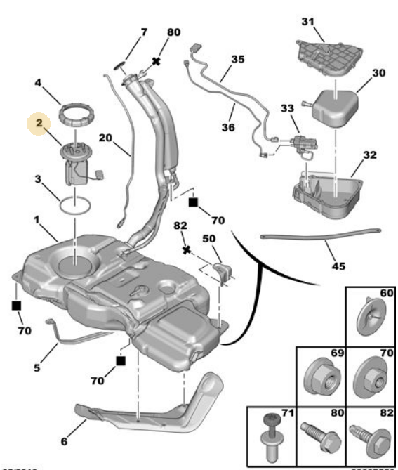

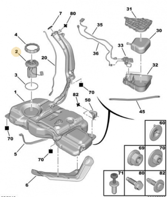

Re: Peugeot 307 2.0 hdi won't start
Ok so confirmed Stefan that you don't have an in-tank pump - just the sender gauge on your 2.0 HDi 138.
So I would be looking at flushing the fuel system through and changing the fuel filter for sure.
