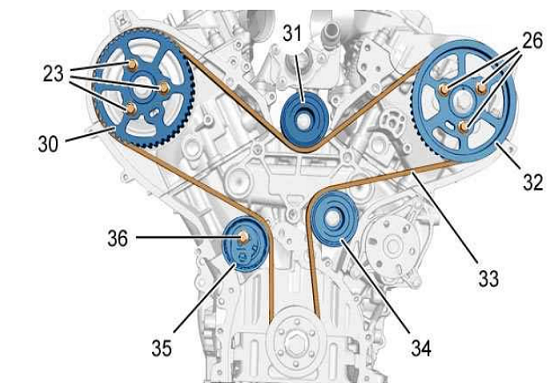

Just the one belt from this diagram of the 3.0 HDi fitted to this engine from what I can see....

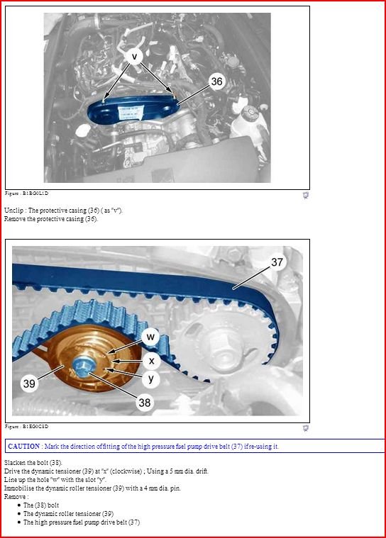

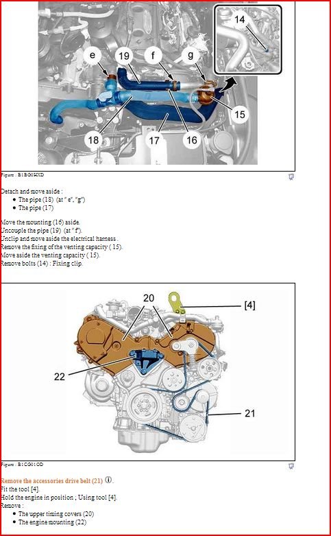

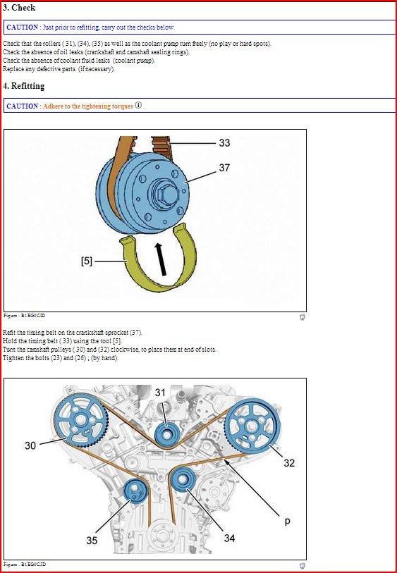

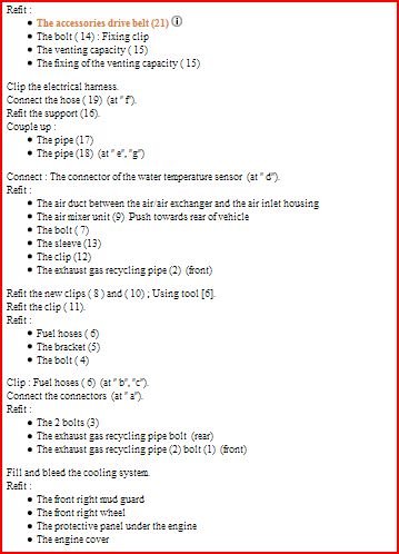

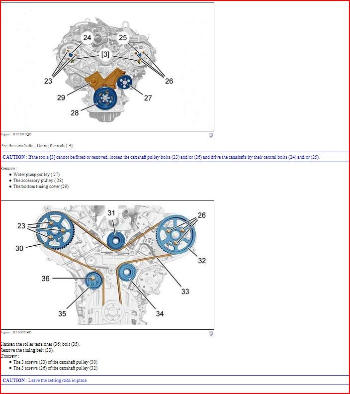

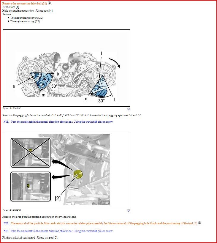

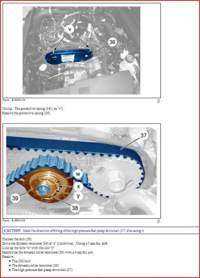

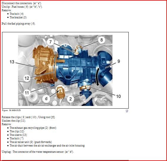

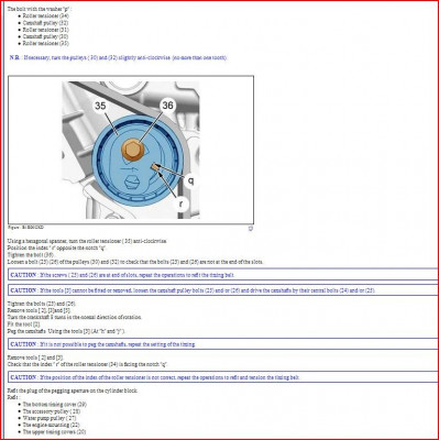

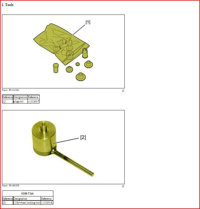

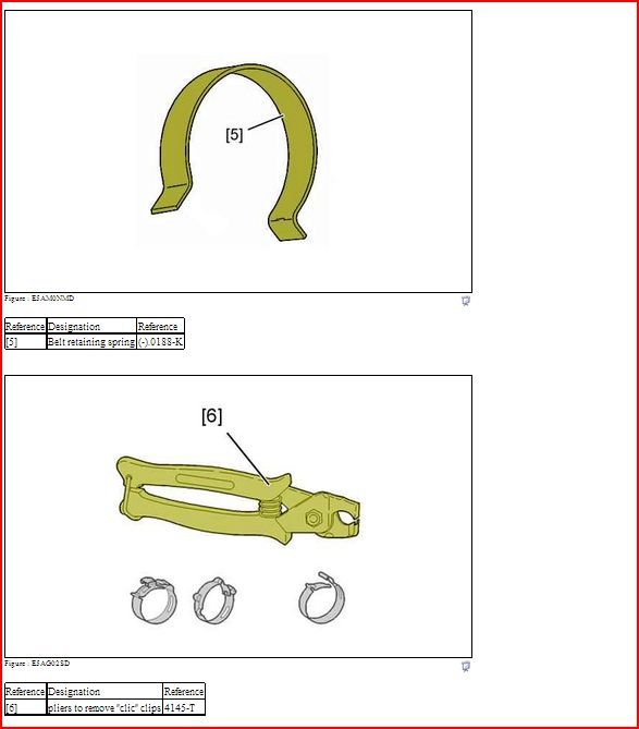

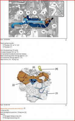

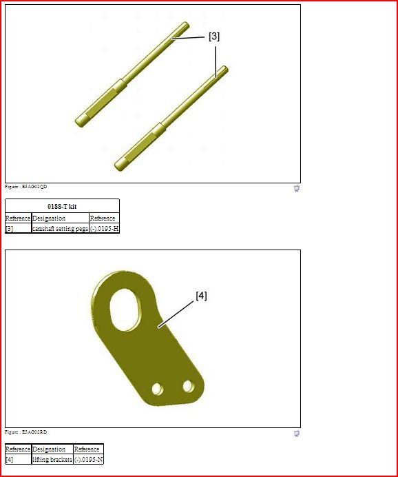

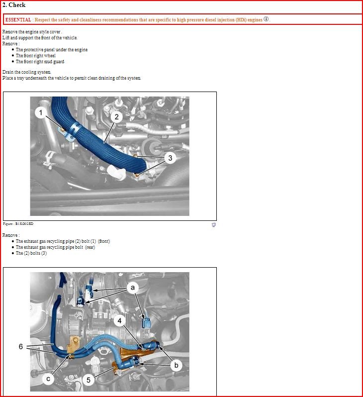

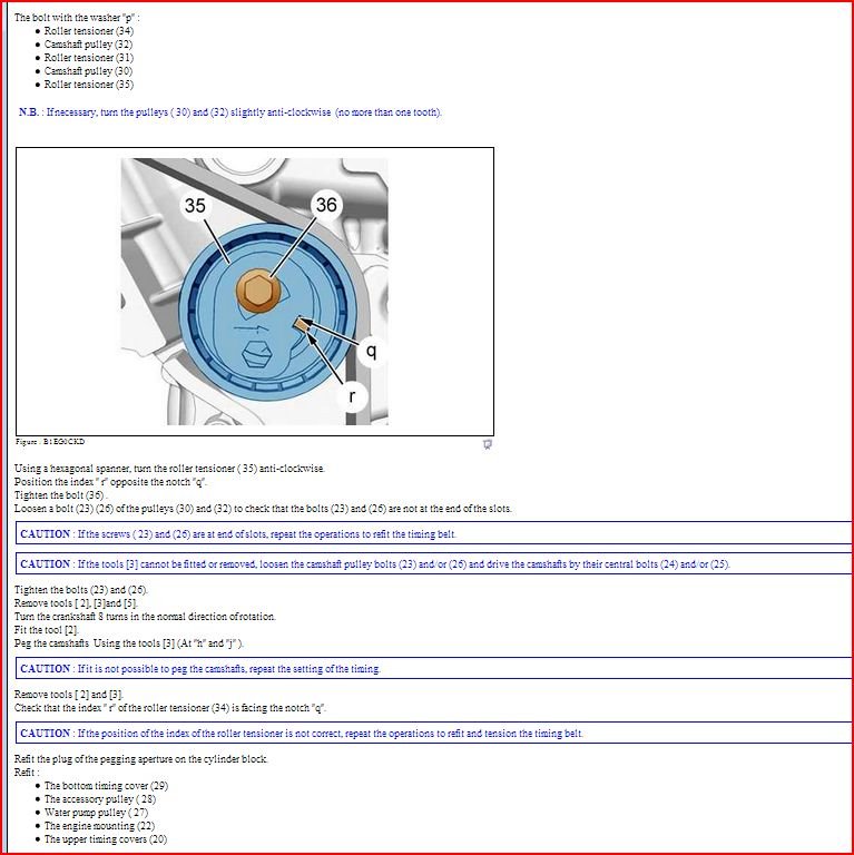

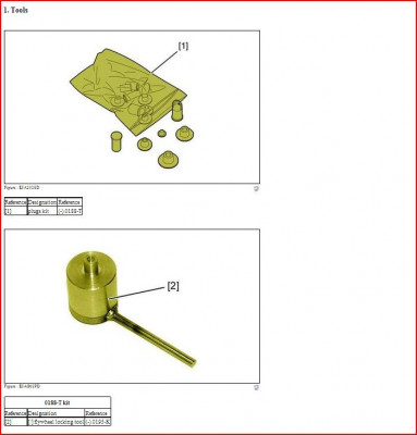

The second belt is on the other end of the engine and drives the HP pump - probably not strictly necessary to change it as it is under less stress, and won't wreck anything if it breaks - the engine will just stop!! The water pump is external and driven by the aux belt, so not too much to worry about changing it unless it is obviously duff - although it is booked at 3.3 hours on its own. Here is the timing belt in all its g(l)ory!

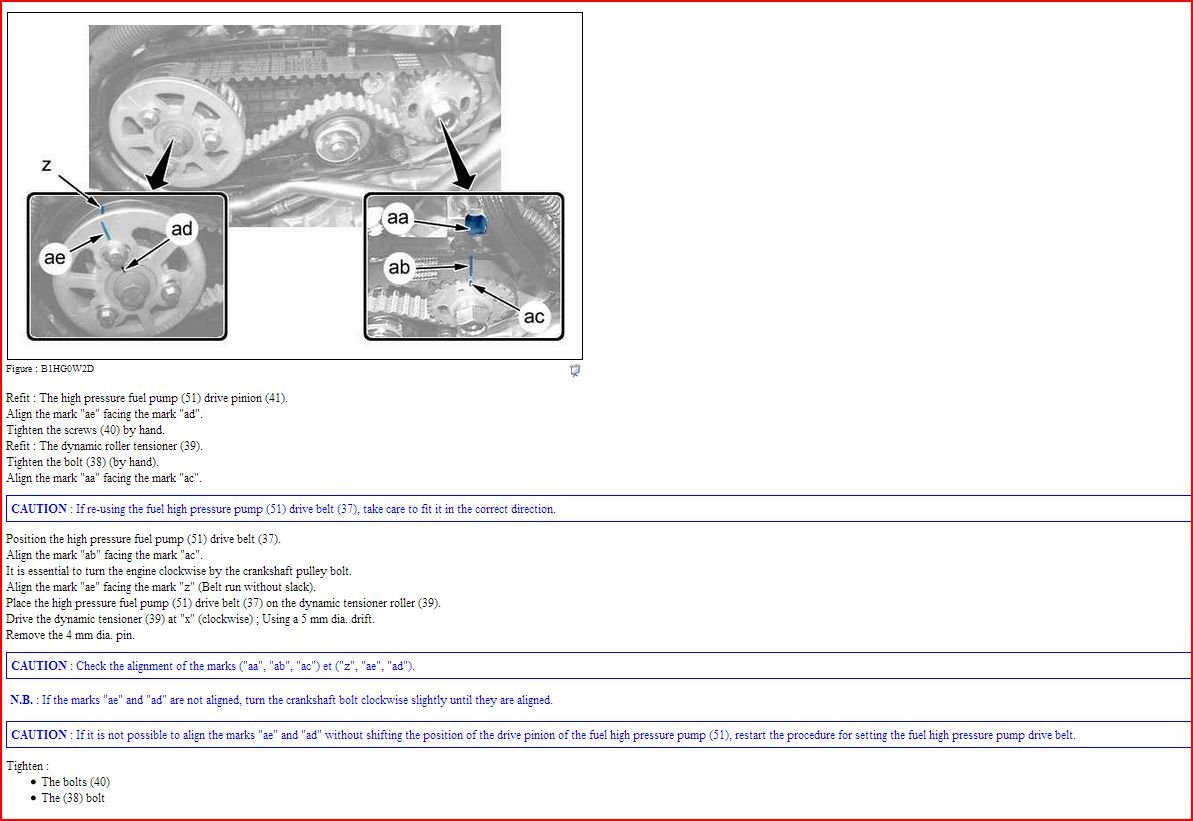

And the rear belt - couldn't find a dedicated procedure, but this is part of the HP pump change - this belt is only listed at 0.6 hours; just remove what is needed from above it to get the cover off.

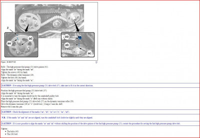

Retensioning the belt:
