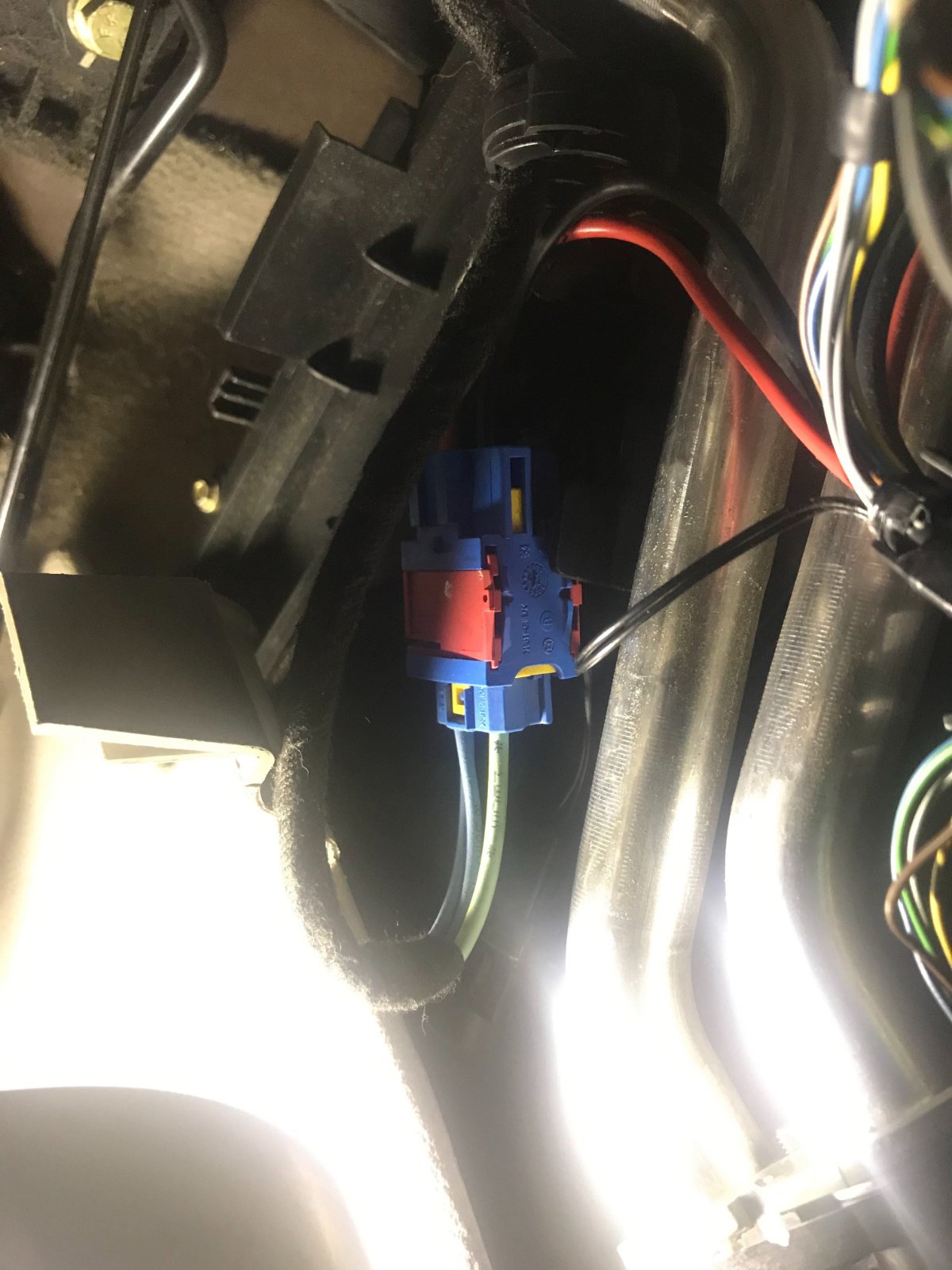

However, I've found a connector for the cable I need to check that comes from the engine bay beside the drivers' footwell. Does anyone know how these connectors come apart? hopefully then I can get to the bottom of the issue
Though the image looks like this is easy to reach the picture is taken from the steering column, so not easy to get a hold of.
