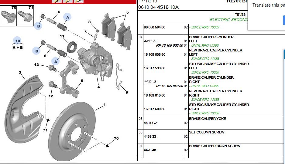

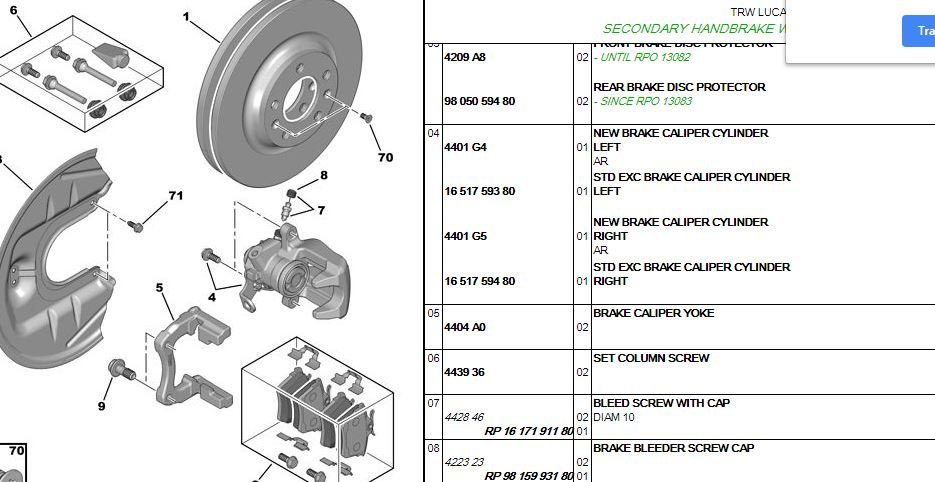

A simple question for a change :-)
Are the rear calipers on the electrically handbraked cars the same as on manually handbraked ones.
I assume it was only the method of yanking the cable that changed and not the calipers themselves?
Looking to replace mine and I don't want to get the wrong ones!
Forum Treasurer
Posts: 12585
Joined: 07 Aug 2002, 17:12
x 1488
Re: C5 X7 rear callipers
Unread post by RichardW »
They're different....
Electric
Manual
centurus2400
Posts: 109
Joined: 17 Aug 2009, 13:41
x 4
Unread post by centurus2400 »
By different does that also mean more expensive :rofl2:
Forum Treasurer
Posts: 12585
x 1488
Not much different, but electric are slightly cheaper at £295 vs £314 for the manual ones :shock:
For that price I'd want them hand built and polished! Sure you will get them cheaper elsewhere....
