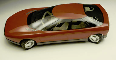

I think Citroen flirted with programmed rear wheel steering (passive) - fitted to the Citroen ZX and some other models - but unfortunately the real deal 4 wheel steering form the Activa Concept was a feature that never actually made it into the production version of the Activa :( This was back in 1988.....
