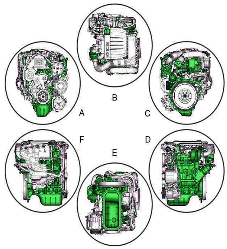

Click Image to Zoom Zone "A" Timing face
Zone "B" Upper face
Zone "C" Coupling face
Zone "D" Exhaust face
Zone "E" Lower panel
Zone "F" Inlet face
If you can identify the general zone of the oil leak from the areas above, then I might be able to give you some more detail.
