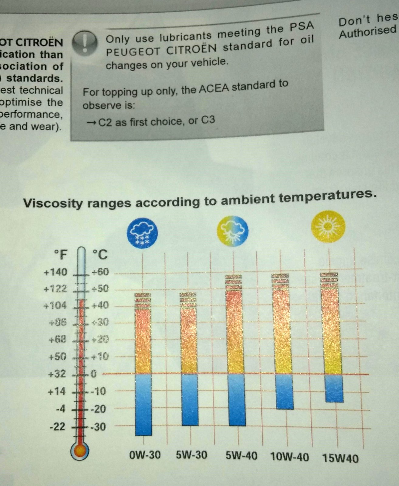

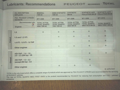

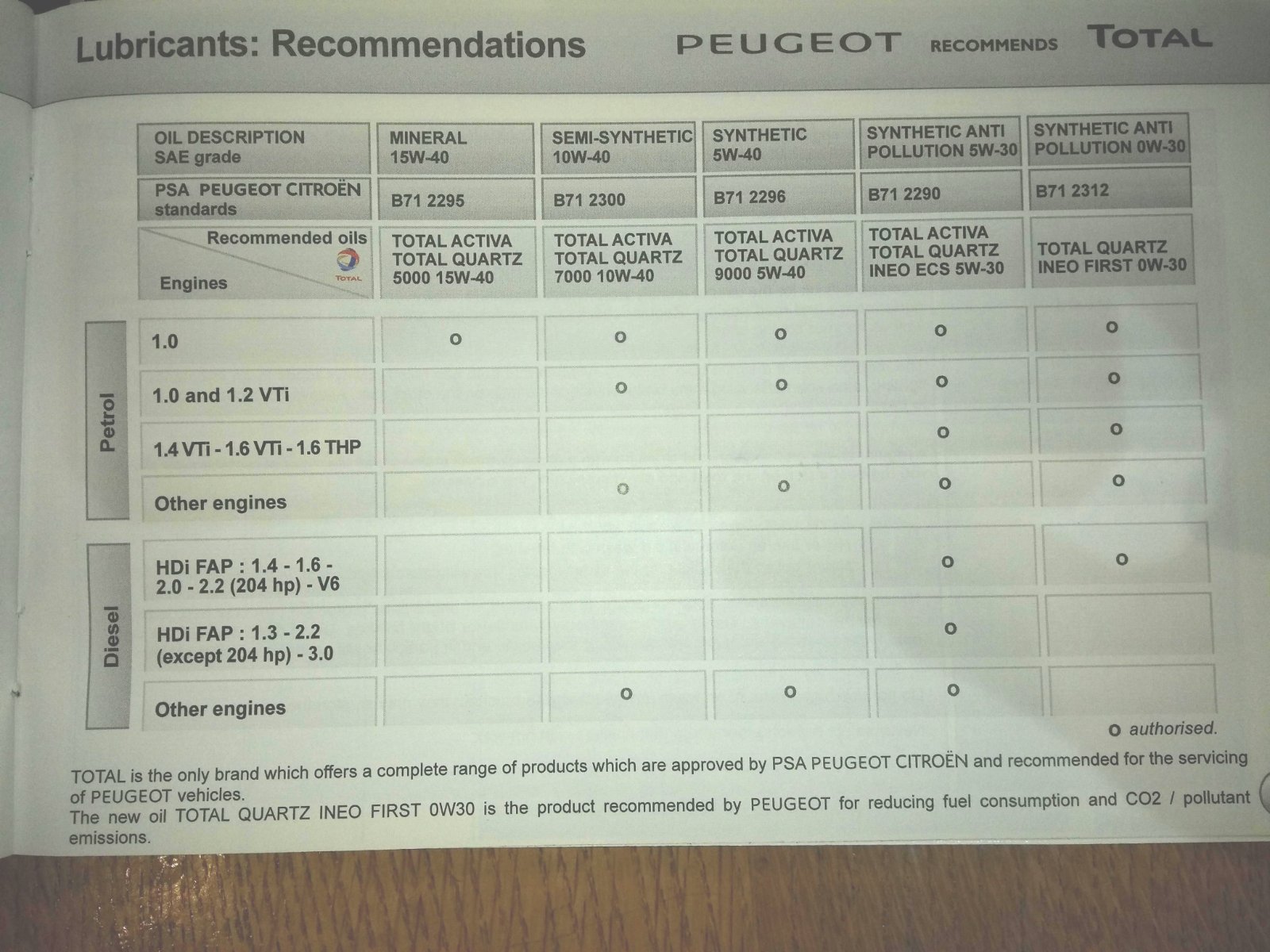

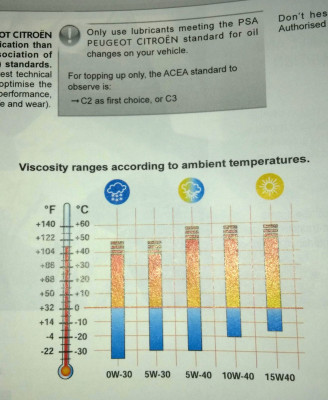

Extracts from the handbook for my 2013 3008 on oil...
You can see that C2 is recommended top up spec (C2 is actually better than C3), and 0W-30 is only implicated when used in very cold conditions - although the tag line under the recommended oils table says that the preference is for 0W30 oil for fuel consupmtion, but then it's not authorised for the larger diesel engines!!
