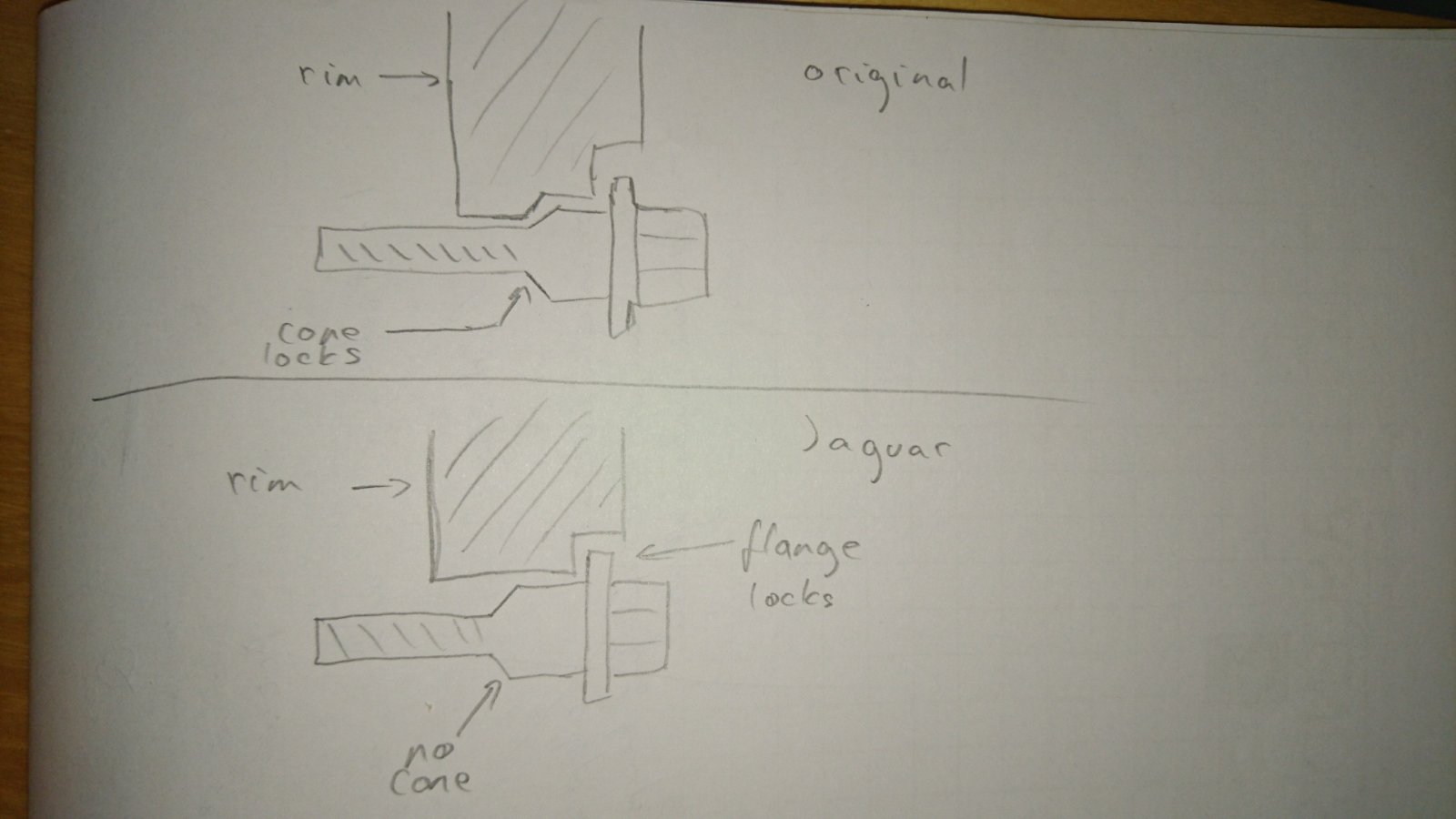

Update: I bought the wheel, I gained a huge amount of space in the boot, and most details are fine (centre bore, brake space is even better than original, offset seems identical) apart from bolt locking. The original has a conical tapering to tighten the wheel in place, while the Jaguar one has nothing, thus the wheel is tightened by the bolt flange (I'll post a picture). As it is now, I'm pointlessly carrying the spare because I'd be afraid to drive with the wheel tightened like that. I'll look for some heftier bolts, and post the results.

I think you'll find that the X7 alloy wheels also use the flat washer for tightening up against. The taper section of the bolt is used for non-alloy spare wheels.

Hmm... I start to doubt my own memoryPaul-R wrote: 29 Dec 2019, 11:29 I think you'll find that the X7 alloy wheels also use the flat washer for tightening up against. The taper section of the bolt is used for non-alloy spare wheels.

There may be a conical section but the bolt doesn't engage against it.

You are completely right. I confirm that the conical sections exists on my rims, but that it would be too thin to hold the wheel. The rim is tightened against the bolt washers. Thus I'm satisfied with the setup and should I ever need to use the space saver, I will do it with peace of mind.Paul-R wrote: 29 Dec 2019, 13:33 There may be a conical section but the bolt doesn't engage against it.
