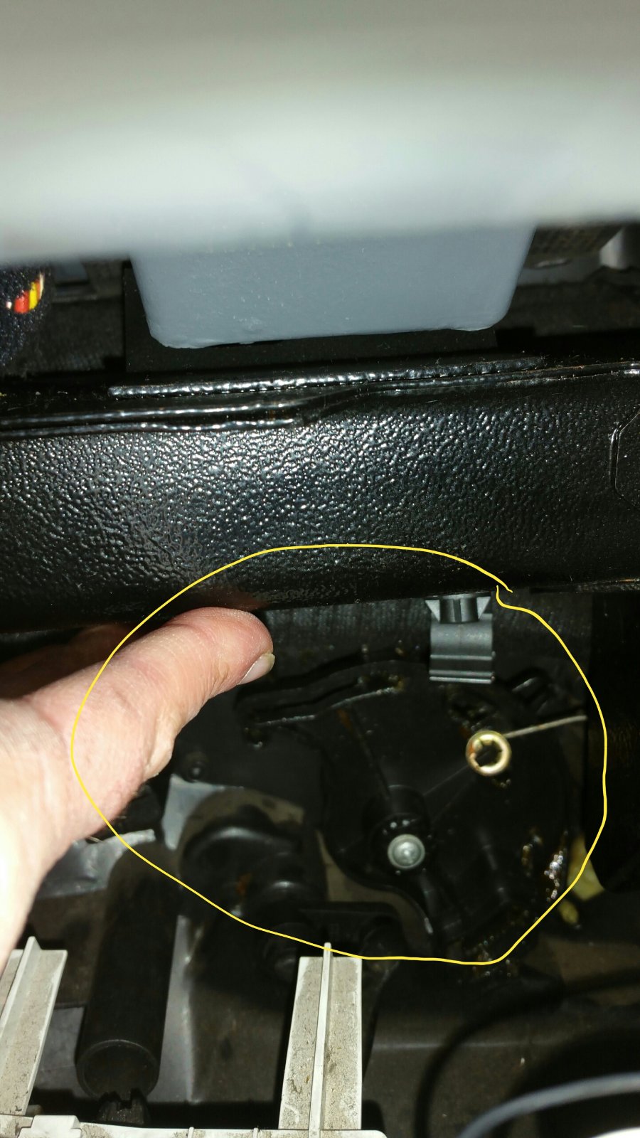

Have finally got around to investigating this. When you turn the area selector, is to blow onto the windscreen or feet on the rear of that is a cable. The other end of that cable is the part/s I think I need to replace. Any idea what these are called, or are you aware of a full comprehensive parts catalogue I can look through?
doozynit
- Posts: 29
- Joined: 20 Oct 2019, 14:38
- x 2
Re: 2006 Citroen relay. 2.2 pollen filter replacement.
I should have put more detail there.
When I turn the selector I can see the first bit of the mechanism moving but not the second part, it seems there should be a little metal rod connecting the two. This bit is missing so when I use the selector nothing happens and the system is kinda stuck in a no man's land.

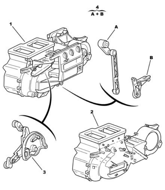

Ok, so I think you may be looking at part (3) below, the heater control lever assembly. Item (4) combines the other levers (A) & (B).
Part (3) is part number: 6451T3
Part (4) is part number: 6451T4
But these are no longer available from Citroen. I've included the part numbers to help you search for a second hand one if necessary.
