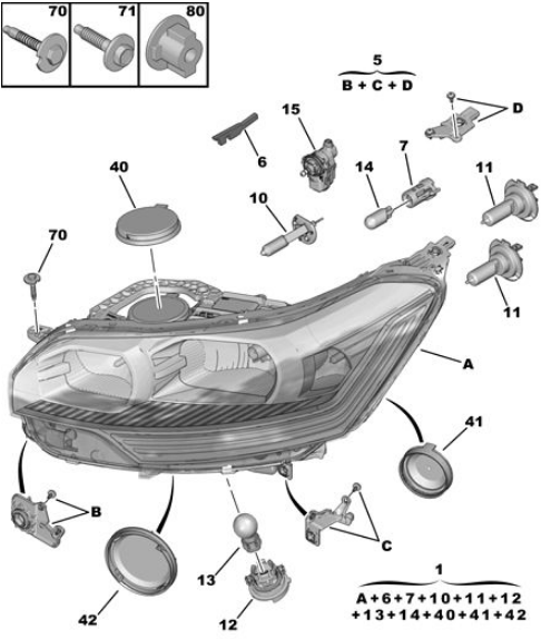

Ok, so if it is the DRL, these can be a pig to get out - especially if they are the original factory ones.
The good news is that they used to be about £40 a bulb (!) but they now sell these as either the bulb or the bulb holder.
The part for the bulb (HP24W) is 1616430880, cost £3.73 inc. VAT each
The Holder is 621698 and costs £13.75 each inc. VAT (although it doesn't specify if this is with or without a bulb) - I suspect without.
Item 12 below:

Thanks Marc, as usual extremely helpful, unfortunately it is the nearside DRL ( the hardest to access ) is that bulb for £3.73 from Citroen or elsewhere ? ..... as for sensor audio, i will investigate once weather clears ... thank you once more.

Yes, those prices are direct from Citroen - which was surprising as they were £40 a pop not too long ago. The bulbs can be a faff trying to separate from the holder as they are secured by plastic lugs that are extremely tight at the neck - which, as a result of trying to keep all the tabs apart and trying to extract them can cause wither the tabs to snap, or the long pins from the bulb to break off. If they do break off, it can be difficult to extract all the pin from the holes before inserting the new bulbs in the holder.
Amazon sell the pair (Valeo) £47:
https://www.amazon.co.uk/Valeo-HP24-Bul ... B016OVL2OG
So worth on the bulb change - and they should really be changed in pairs as the other one is likely to go soon too.
I would check with Citroen as to whether the holders contain the bulbs with them - which may be a better solution if they do for the less adventurous.
When I did mine, I had the intention of replacing the halogens with longer life whiter LEDs. You can see my post here - but mine were in so tight, I paid the dealer to part remove the bumper and retrieve the DRL bulb holders for me. I then made the modifications to the holders to accommodate the new LEDs (I had to trim the plastic to allow them to fit in tightly) before refitting myself:
https://www.frenchcarforum.co.uk/forum/ ... 87#p464087

Wow ..... who would have thought a bulb would be so difficult? i think I'll try and remove the bulb and holder first, i looked at the LED's myself, but really want "plug n play" as I'm not too bothered about aesthetics as it's the company workhorse estate, it's been lookef after by Citroen it's entire life, but at nearly 10 yrs old and 100,000 miles it no longer warrants their charges, and to be honest I'm pretty handy with the tools, if not a little stiffer and unable to move as fluidly as i once did, but I'll give it a go, although looking at it you're right .... what a pig of position !

Well i got the bulb and holder out with only mild lacerations, however, the fun really started at Sportiff Main agent, said they do not sell the bulb separately, only with the holder, don't keep them in stock and £64.00 inc VAT, when i asked them to check this they proceeded to print off a directive to their parts dept stating exactly that, "HP24 bulb and holder is not separable and to be sold as complete unit" now we know they come apart, but they wete not interested, order only, and as complete unit ! .....Help .... any new ideas or sources as i am definitely NOT paying that for a bulb.

There are a couple of options you could look at, starting with LEDs (but you MUST check they are compatible). Here are a couple of choices, but please check they are suitable first;
https://www.ebay.co.uk/itm/HP24W-G4-7-5 ... 1c919bee55
https://www.ebay.co.uk/itm/2X-HP24W-G4- ... 85f5004a56
Failing LEDs, how about these;
https://www.ebay.co.uk/itm/PEUGEOT-3008 ... SwfmldB-h5
- x 6963
Re: C5 Parking sensor display works but no sound / Beep ?
Or those on the Amazon link I gave you before:DSlover wrote: 02 Dec 2019, 14:10 Well i got the bulb and holder out with only mild lacerations, however, the fun really started at Sportiff Main agent, said they do not sell the bulb separately, only with the holder, don't keep them in stock and £64.00 inc VAT, when i asked them to check this they proceeded to print off a directive to their parts dept stating exactly that, "HP24 bulb and holder is not separable and to be sold as complete unit" now we know they come apart, but they wete not interested, order only, and as complete unit ! .....Help .... any new ideas or sources as i am definitely NOT paying that for a bulb.
These are Valeo branded ones, so will be good quality and include the holders for a pair.
