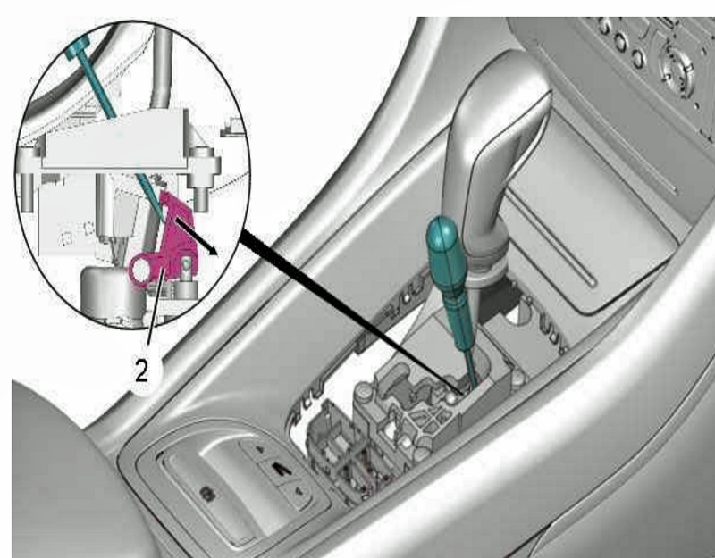

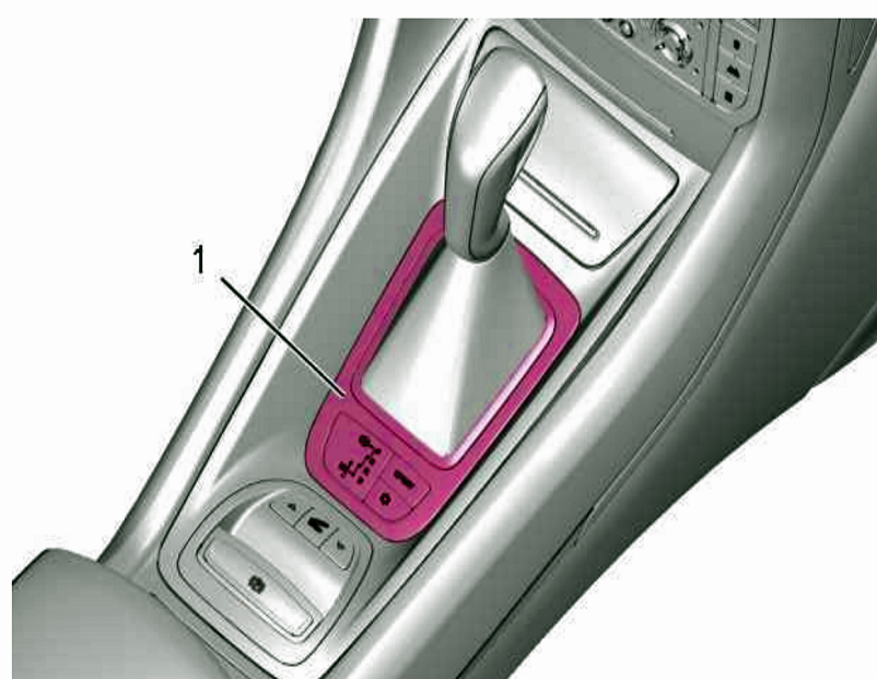

I know you haven't mentioned that you cannot move the selector from Park at present, but the causes of malfunction can arise from the following elements:
- The battery voltage
- The "shift lock"
- The selector lever position switch
- The automatic gearbox ECU
- The wiring harness
Unclip and move aside the bezel (1). | Unlock the "shift lock" with the aid of a screwdriver Press on (2) (In the direction of the arrow ). Move the selector lever to disengage it from the "P" position. |
