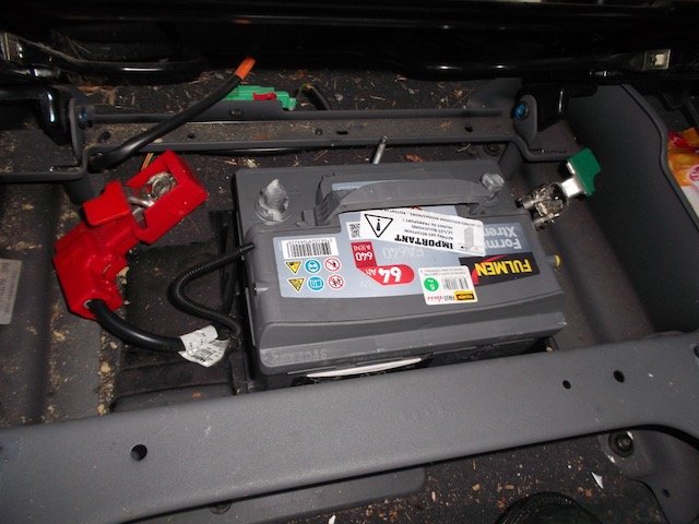

Having managed to change the battery, which is under the driver's seat in a French LHD model, which I have living in France, and only achieved after buying a number 40 Torx screwdriver bit!
This was required to remove the three screws holding the seat down so as to be able to swing the seat up out of the way. NB no easy clips as shown on most YouTube Videos for RHD models where the battery is mounted under the passenger seat.
The old battery had a plastic pipe fitted to the vent on the left-hand side of the old battery looking from the rear.
The new battery vent on the left-hand side has the black fixed plug in it and the yellow removable one is on the right-hand side.
Now the first question: Do I need to extend the plastic tube somehow and push it into the vacated yellow plug hole or is it OK not to bother?
My worry is if the acid or the acid fumes pass into the car as opposed to an under bonnet 'normal' battery position where it would vent to the open air.

You must vent cabin-located batteries! So yes either get the correct battery type or do a mod, but you must vent it.
