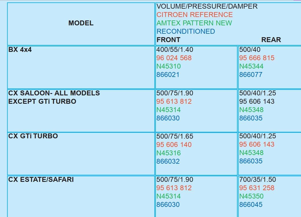

x 1751
Re: GTI Turbo 'squatting under power
If air has got into the system (eg because of low fluid level) and worked its way towards the rear spheres, the back end will be abnormally soft, because the air is compressible.
The trapped air could act like "an additional sphere", bringing additional softness, just like the centre spheres switching in on Hydractive.
Have checked the CX repair manual, but cannot see any instruction for bleeding the suspension system, so I assume it is self-bleeding, given a good few Citrobics. Worth checking for air in the reservoir fluid (dip a sample, after a drive). If anything other than a few microbubbles, that needs sorting.
The CX sphere data I have...
(Volume/Pressure/Damping)

Unread post by Bilkob »
So it looks like the rear spheres are the same for saloon and turbo......
