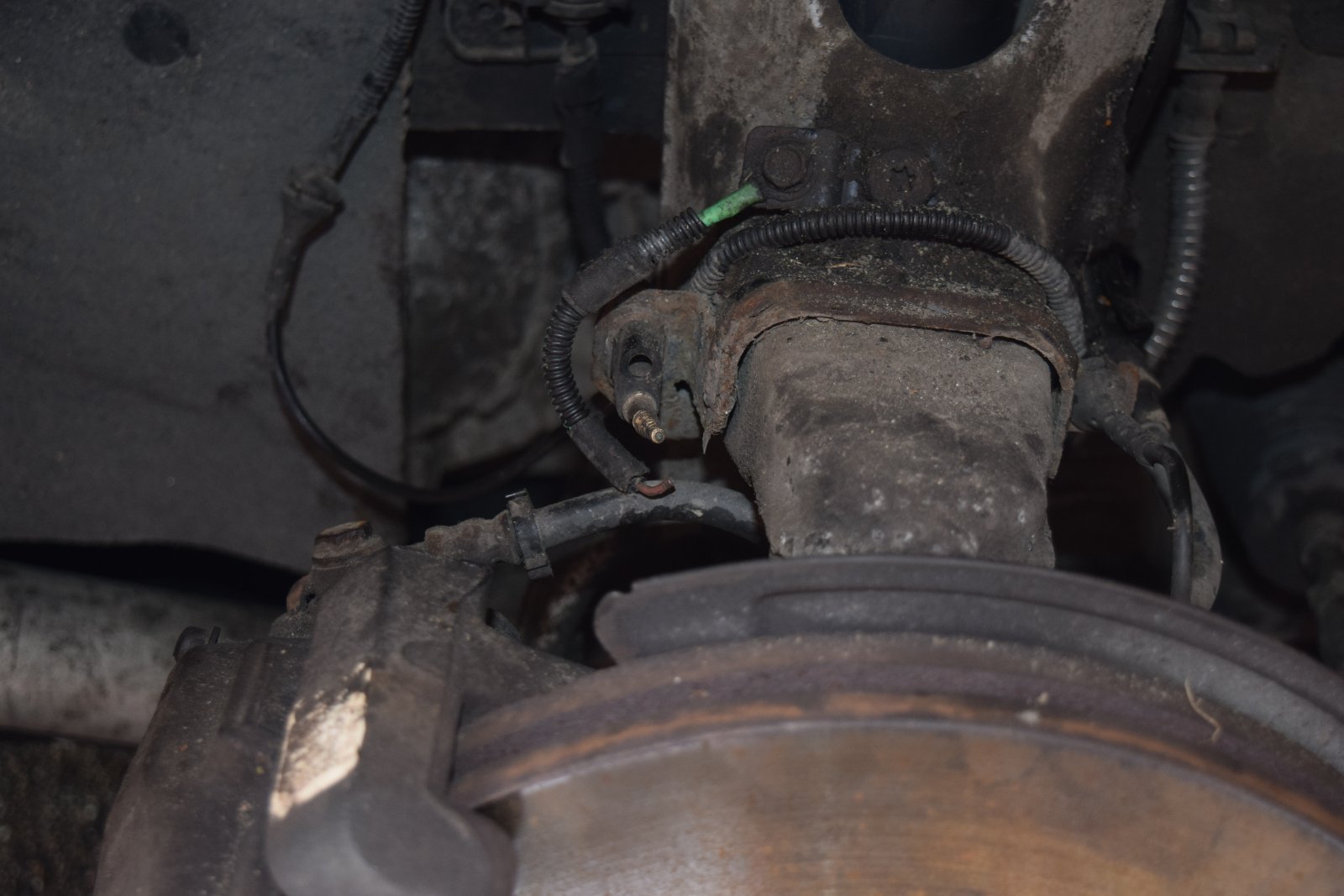

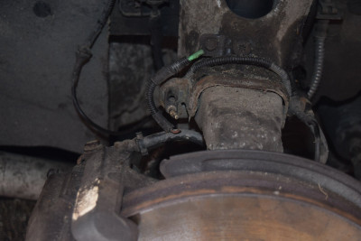

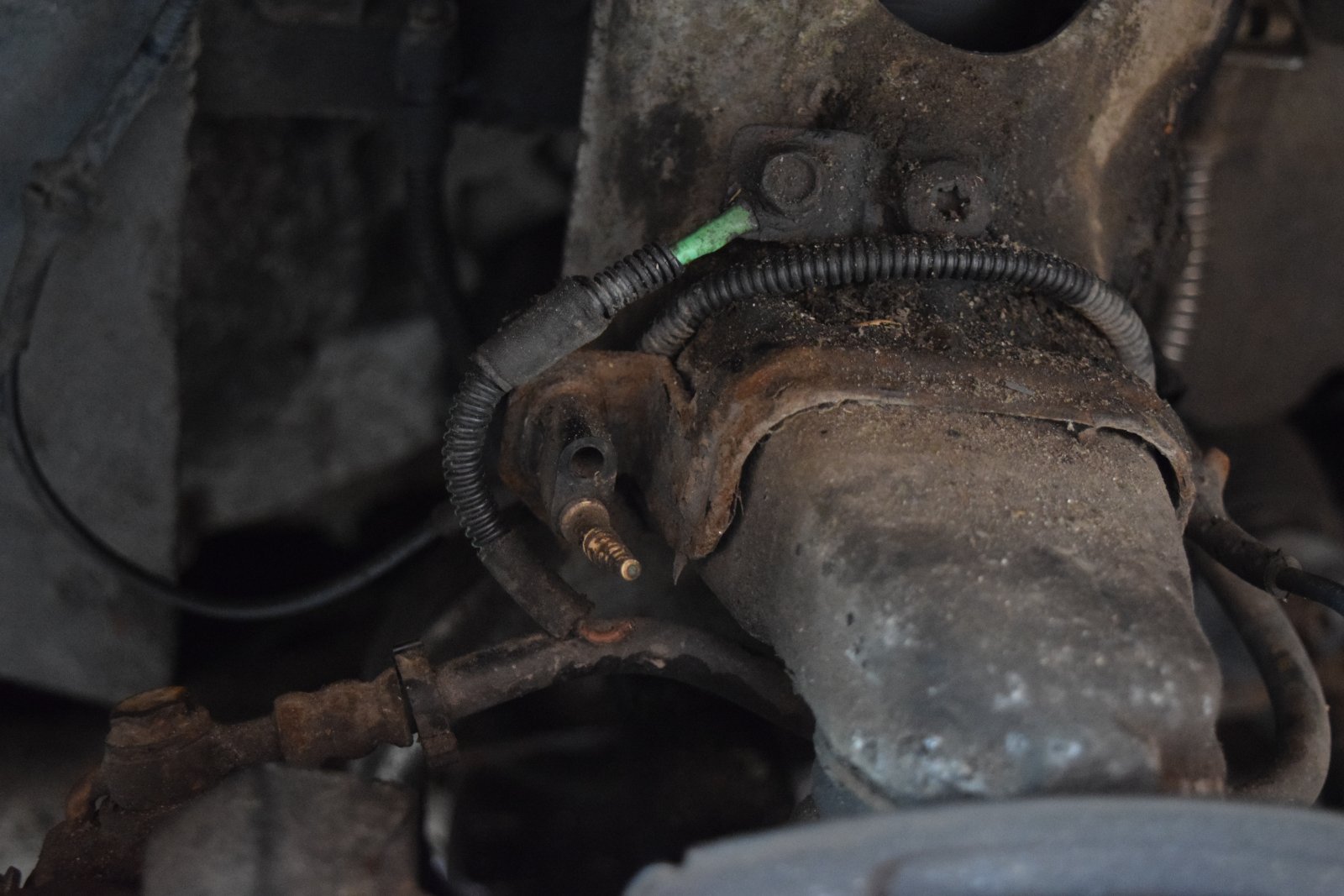

Following my successful swap of the front passenger side suspension strut i noticed a couple of broken wires.
Looks to me like they are brake wear indicator wires but there is no warning light on dashboard. Point is I've MOT in a couple of weeks, is this a failure? Pads and discs look fine with lots of meat on them.
any advice is always appreciated
Are these boken wires important?

You do have a brake warning - but it is not a bulb - it appears on the dashboard LCD display with a message:
There is a repair kit you can get for these. If there are no warnings on the dash, then you should be fine.

Brake pad wear warning is usually triggered by the single wire to the pad making contact with chassis ground (the brake disc), so if the wire gets disconnected/broken, nothing illuminates. Although this is 'fail unsafe', the pad warning is not regarded as safety-critical (like brake fluid loss), so is an acceptable arrangement.
Getting the correct route for the wire is important, to avoid it getting chafed by hub/wheel movement.

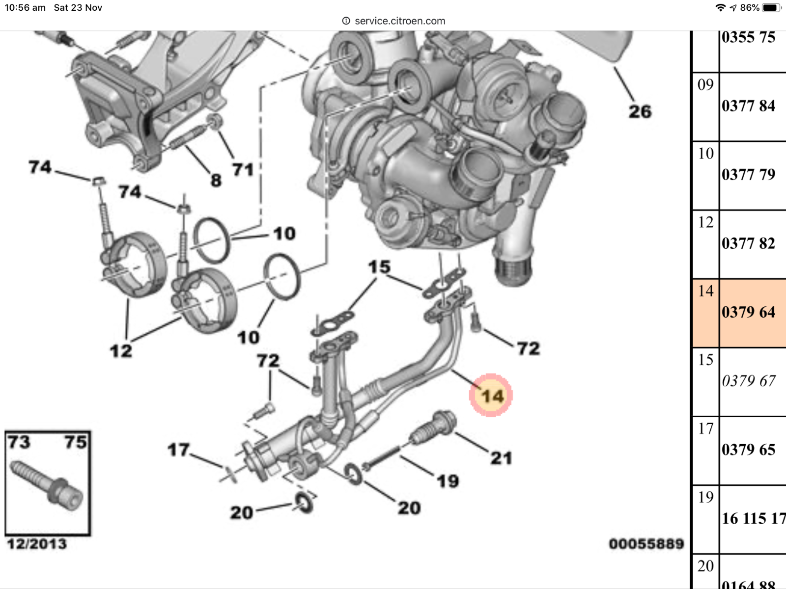

Thinking back, when my car was about 5 years old, it developed a bad leak from the twin turbo lubrication supply which necessitated replacing the oil feed and return pipe work. The pipe work was quite complex (item 14) and I reckoned it was going to be about £200 or £300. I was pleasantly amazed when it was only about £50
However, I reckon that was a mistake because I see it is now over £200.
I was also pretty pleased with myself for replacing it without having to remove the engine which is the official Citroen way ! It was only afterwards that I found out there had been a service bulletin about the problem so maybe I could have got them to do it ! No, thinking about it, I think I was happier having done it myself.

Thanks for the tips and reassurance guys, yes defo no warning lamps on dashboard so I'm assuming the drivers side wires must be intact. Yeah be nice to pick up a repair kit for a few quid but at that price I think I will leave it
