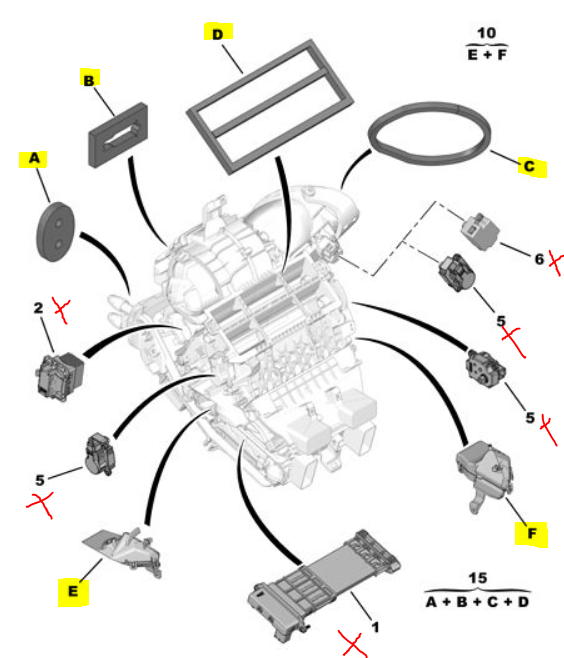

You only have Single Air Conditioning, without any electrical motor reducers or air mixers, and no supplementary heating resistance for rapid cabin heating.

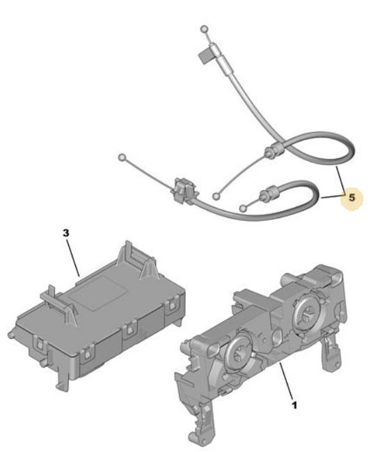

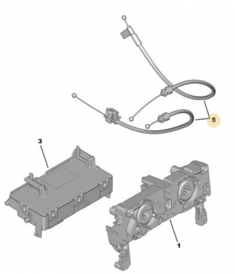

So from what you have said your problem would seem to lie with the air mixing control. The first diagram in the table, so the right hand control cable attached to the temperature dial. So this is the place to start looking I would suggest. Maybe the cable has detached itself from the control dial or deeper at the flap end.....
Looking at the diagram you only have the items highlighted in yellow and not the motor reducers and equipment that I have crossed out in red.

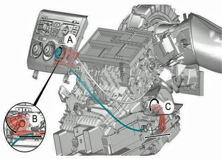

You have the cable operated system as shown below - which will operate the air mixing flaps manually and also the air mixing.

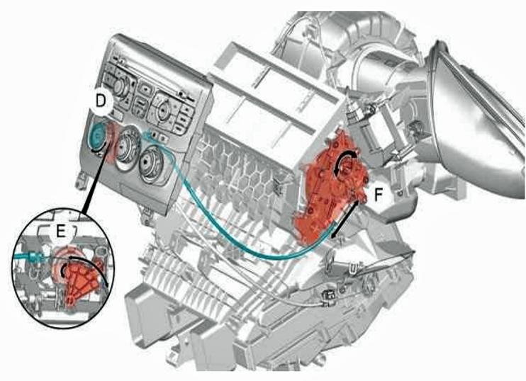

| This is how the temperature is changed: "A" The user actions the control: Temperature. "B" The temperature control operates a gear which pulls or pushes the cable depending on the command. "C" The cable operates a gear on the aircon unit: The gear is connected to the mixing flaps. | Air Distribution Function "D" The user actions the control: Air distribution. "E" The air distribution control operates a gear which pulls or pushes the cable depending on the command. "F" The cable operates a gear on the aircon unit: The gear is connected to the distribution, demisting, ventilation and footwell flaps. |

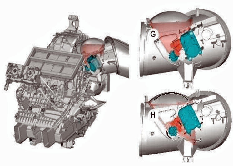

| Air Intake The gear located on the air conditioning unit is operated by a stepper motor controlled by the air conditioning control panel. "G" Air intake flap: Open. "H" Air intake flap: Closed. |
