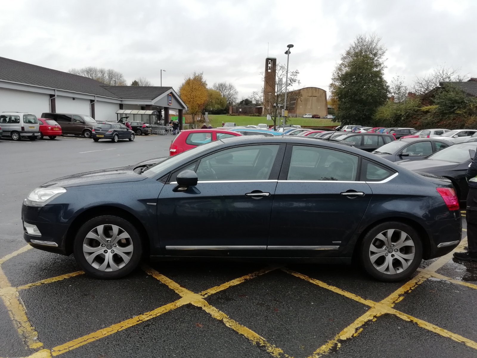

I just used lexia for the ride height and haven't tried to manually adjust it. I followed the procedure, but didn't work and by putting random numbers I lowered the front end a bit, uploading a picture to show how it looks. Couldn't find one from before, though. There's no any obvious difference with sport button on/off.
