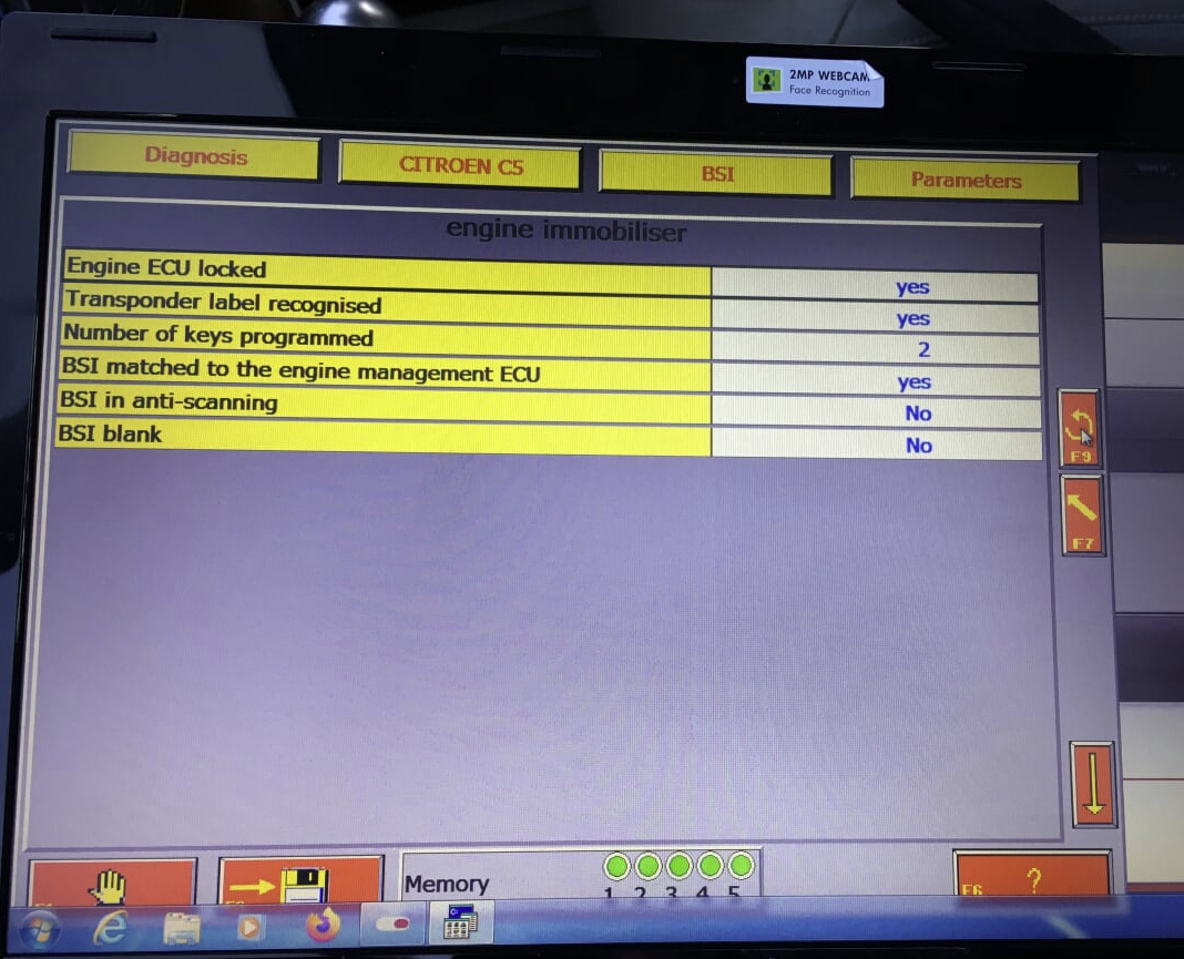

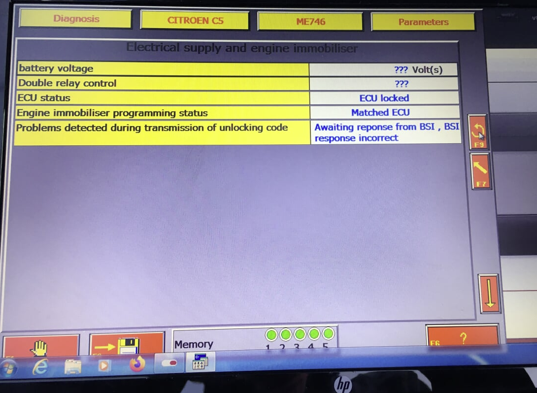

I've plugged it into Lexia and I'm getting the attached reports in the BSI and ECU windows which would show that the ECU is matched but doesn't appear to be communicating with the BSI correctly. It says "Awaiting response from BSI, BSI response incorrect". But it also says that the BSI is matched to the engine management ECU. I'm therefore confused and don't really know where to go from here.

SO, mk 1. Had a BSI fault, we replaced BSI, ECU, transponder (unfortunately only one replacement key). I've tried to start the car and just turns over. When I look in lexia I see the attached screen shots.

So the BSIs cannot be reprogrammed once coded. But if you mean the confidential code for coding the keys, then you will need this to undertake that operation. Once the key transponders are matched and coded, they can't be re-coded to another BSI, but can be coded again to the same BSI. So I would start by getting the confidential codes of both your car and the donor car. Citroen will provide the code for a fee, on proof of car ownership, ID and address. As for the donor vehicle - if you have an invoice - or something to say it has been written off maybe....
So that is the first thing I would do - with the power cut to the BSIs, Engine ECU for extended periods, it is likely the transponders in the fobs need re-coding to their original BSIs again - but you will need the respective codes for each to do it.
