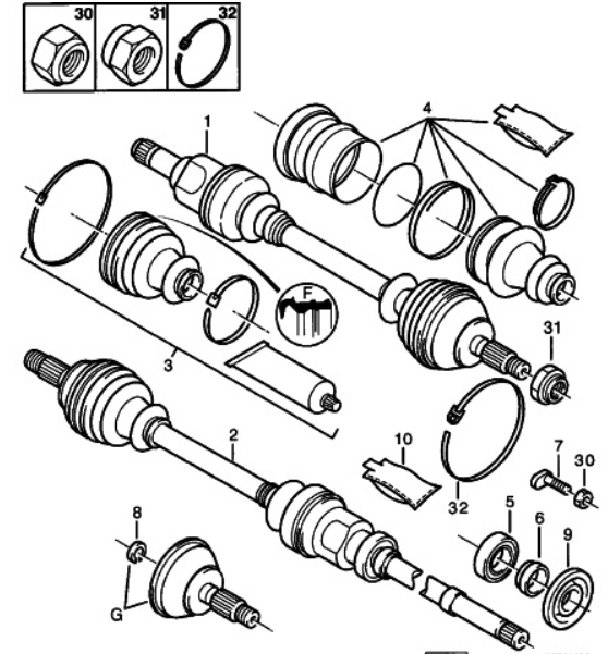

The driveshafts are no longer available new, but the gaiter kits are:markstansfield wrote: 12 Nov 2019, 18:16 HI,
I have just bought (3 months ago) a Citroen C15 champ 2001 with a 1.9 diesel. I need various parts but i am really needing CV joint kits etc
Where can I buy them from/ Is there anyone on the forum who deals in parts?
I am based in Kendal but travel UK wide so pick not a problem
All help greatly appreciated
Best Regards
Mark
Pick the numbers of the parts you want and I'll be able to get you the part numbers that you can then search with on the aftermarket or buy from the dealer.

Thank you for replying to my post. I need the drive shafts - the bearings have failed so I need to find these.
Thanks for the tips on having a cone and spare ball joint gaiters.
